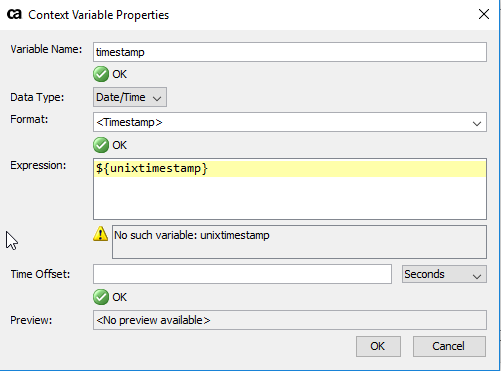

    And should then be able to construct it with the Set-Context  with
        Data Type : Date/Time
        from a Format: of :
              <Timestamp>
             <Second Timestamp>
             <Millisec Timestamp>
    That would be what I would start experimenting with.

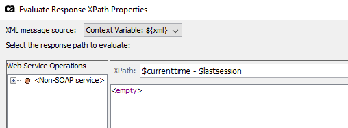

    Calculation can be done on time objects via XPath
    Here is one I have setup : (not quite the same calculation) but :
    You can see we create a dummy xml object, and then here I have two unix timestamp objects :
    And then a calculation via XPath to gets the delta time :
    You can see that the input values are "String" but are then converted to numbers via XPah.
    And I store the limittime.result as the timedelta.
    So in your case, I'd expect you can do a similar calculation - as per :

    To give you the unix timestamp from the Microsoft one, and then use the Set Context Variable to get the result value interpreted as a Date/Time field. eg :
