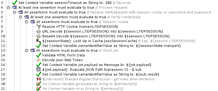

        1. modify the 'Create Signed Bearer-Token SAML Token' assertion to add some attributes (as needed)
        2. associate that PKI to the assertion that signs the SAML AND  You also have to associate the PKI to the assertion "Build SAML Protocol Response" ( the assertion below the one shown in the screenshot [line28])

      1. substitute the context variable in the service  where it mentions serviceProviderURL with the ACS URL you have in the Portal:
      2. open the 'Create Signed Bearer-Token SAML Token' assertion and make sure the Recipient and the Audience restriction to match with the ${serviceProviderURL} and make sure that the message is signed:
    3. Under line 4 of the service, change the logic to fit the requirements (call the next identity provider). See the difference herebelow between the ORIGINAL form-authentication part that Ben created and the OPENID one that I have put in:
      ORIGINAL
      OPENID
