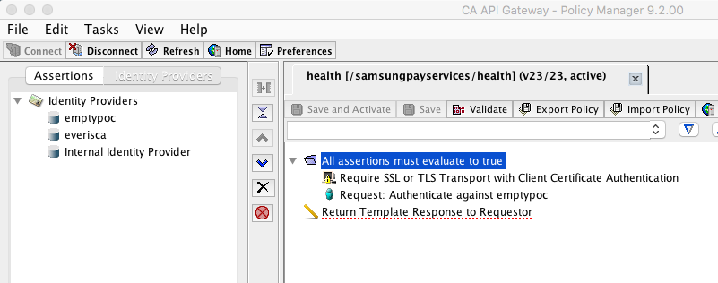

    Hello,
    I have the server certificate and the client certificate, but I can not make the assert "Required SSL or TLS Transport with Client Certificate Authentication" work.

    The steps I have followed are:
    1.- I have created a "Federated Identity Provider"
    2.- I have created a "Federated User"
    What am I missing?

    I think you need an "Authenticate Against Identity Provider" assertion after the "Required SSL or TLS Transport with Client Certificate Authentication" assertion.

    Thanks to the two for answering.
    1. The request reaches the Gateway, however it fails in "Required SSL or TLS Transport with Client Certificate Authentication".
    2. If the JKS has the Gateway certificate fails in "Authenticate Against Identity Provider".
    I look for it to work for me without the gateway certificate.
    debug
    Again, thanks for the help.

    If you test the API with postman including the certificates everything works correctly
