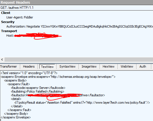

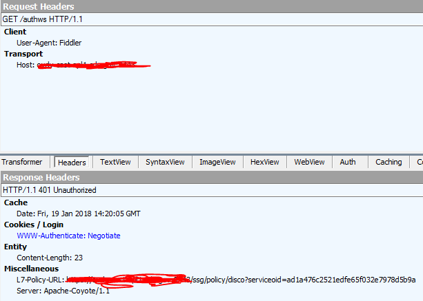

    When making the call via Fiddler I can see API Gateway return the initial 401 Status code with the Authorization: Negotiate header in the Response Headers. Additionally, I can see the client including the Authorization: Negotiate header in the Request after it receives the challenge from the API Gateway. This seems to indicate that Windows Integrated Authentication is working:
