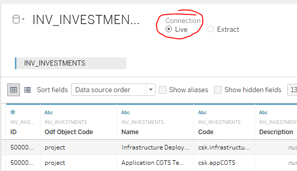

- let's start with a simple example of adding inv_investments to the datasource
- Drag it over. Notice the connection is Live (we'll visit extraction strategy later)

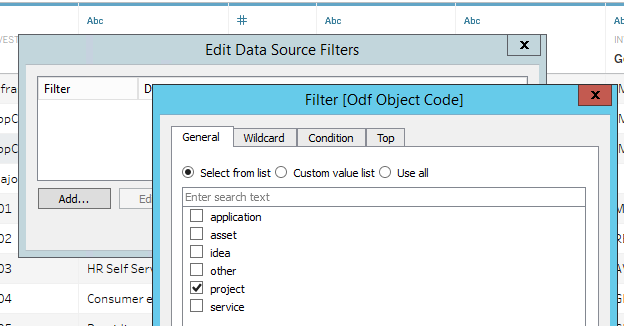

- add a filter so only project data returns

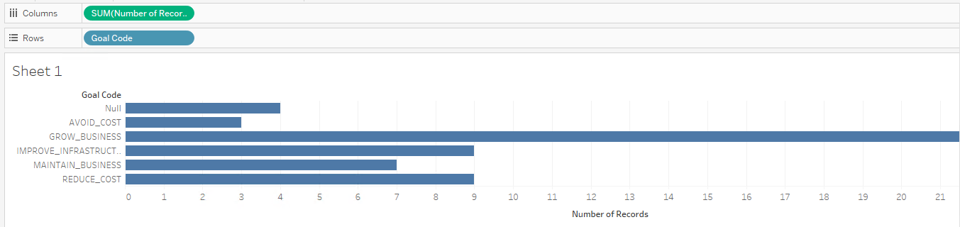

- Let's build a simple chart of number of projects by goal
- drag goal into the rows
- drag number of records measure into the grid
- Should end up with something like this:

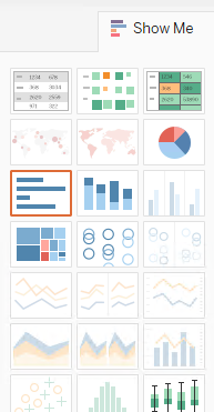

- Click the Horizontal Bars in "Show me"
- We'll end up with something like this

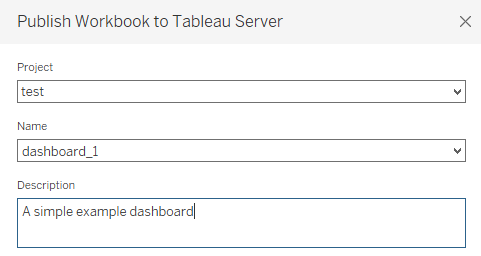

- save the workbook and publish it to your server
- You'll now see the dashboard in the server and can share it with stakeholders
