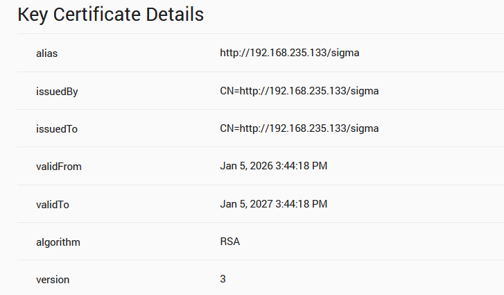

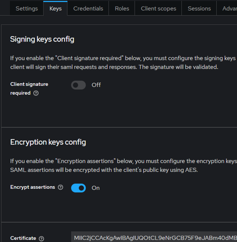

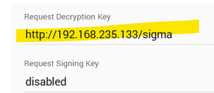

    Next, I uploaded a new certificate into IP, and changed Request Decryption key to use this new cert. Save the setting and perform export SP metadata.
    Then i take this SP metadata and load into my Idp(keycloak)-clients. Setting is loaded correctly with the same new cert.

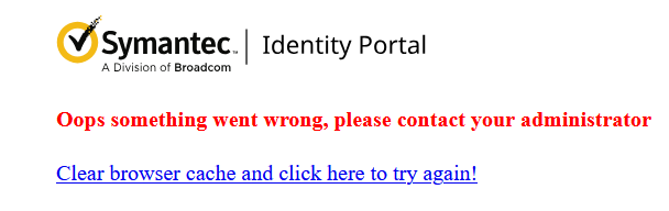

    Next when i test login sigma page, it able to redirect my Idp Login page, so i sign-in with username & password. After that page show error.

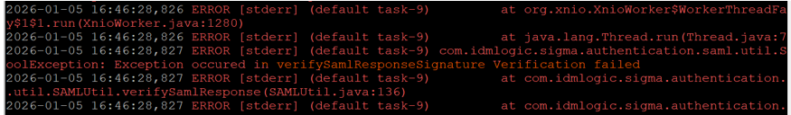

    When i check the IP log, i saw this error Exception occured in verifySamlResponseSignature Verification failed.

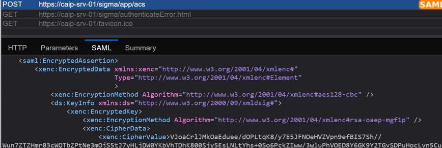

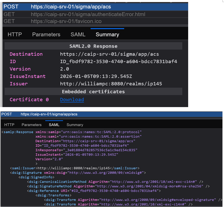

    On the SAML Tracer, i have this result.
    Anyone have faced this issue before ?

    I have checked my Idp, the cert for encryption is loaded correctly.

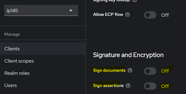

    I have some new finding, in my Idp_clientSP setting by default these 2 setting is turn on Sign document & Sign Assertion.
    If i turn off both setting, then my SP decryption works(user able to login).
    It seems like when SAML Assertion Encryption is turn on together with sign documents=on and sign assertion=on, IdentityPortal login doesnt work.

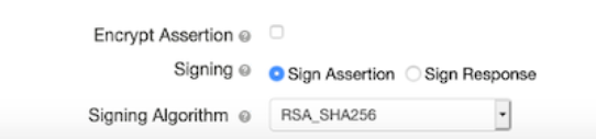

    FYI. I noticed other IDPs is providing this SAML option. where Signing is either Assertion or Response, there is no both option.

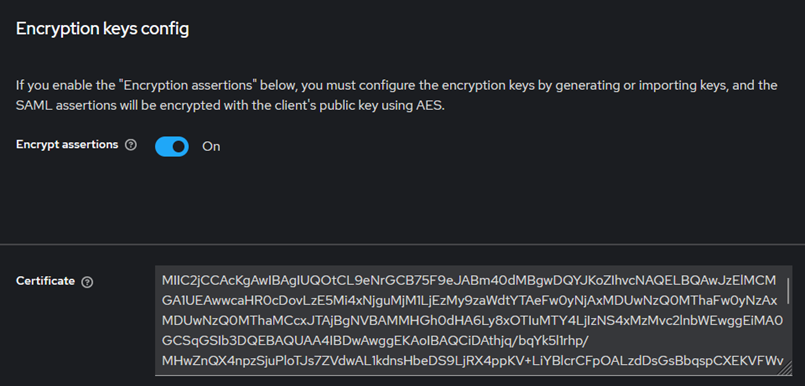

    This is the exported IP-SPMetadata.xml file from IdentityPortal
    It contain certificate info and the tag use=encryption
    After import this IP-SPmetadata.xml into my keycloak SAML – Client, the encrypt assertion on is auto turn on and loaded with certificate, which is the same cert.

    I have tested with enable only sign assertion together with encrypt assertions, and the sigma portal login works.
    It seems like, SAML integration does not work when encrypt assertion is enabled together with sign documents feature.
