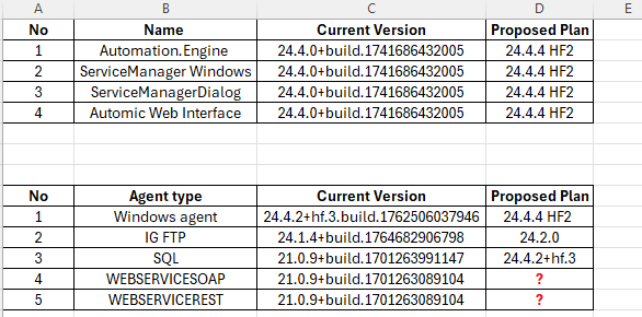

    Our current plan is to upgrade all Automic components from version 24.4.0 to 24.4.4 HF2, including:
    Automation Engine
    Automic Web Interface
    Service Manager
    Service Manager Dialog
    Any other associated Automic components
    Could you please confirm whether 24.4.4 HF2 is the correct and compatible target version for all the above components?
    Could you also please confirm whether upgrading the Automic components from 24.4.0 to 24.4.4 HF2 is a prerequisite before upgrading the agents to 24.4.4?
    Alternatively, can all Automic components remain on version 24.4.0 while the agents are upgraded to version 24.4.4?
    This confirmation is particularly important because we faced many issues following a previous upgrade attempt (for agents) and had to revert the changes. We would therefore like to validate the exact target versions and compatibility across all components before proceeding again.
    Your confirmation would be appreciated as we have almost 150+ agents running across different environments.

    Hi @SHIMIL JOSE
    I suggest the following
    • focus on the latest released Service Pack of the Offering Automic Automation which is v24.4.5 and do not mix versions of AWI, AE, Agent SQL, Windows OS-agent (applies to table 1 lines 1, 2,3 & 4 and table 2 lines 1 & 3)
    • as RA Web Service REST is deprecated, you should use IG REST - latest version v24.2.1 (table 2 line 5)
    • you should use the latest available version of RA Web Service SOAP which is v5.0.1 (table 2 line 4)
    Michael
