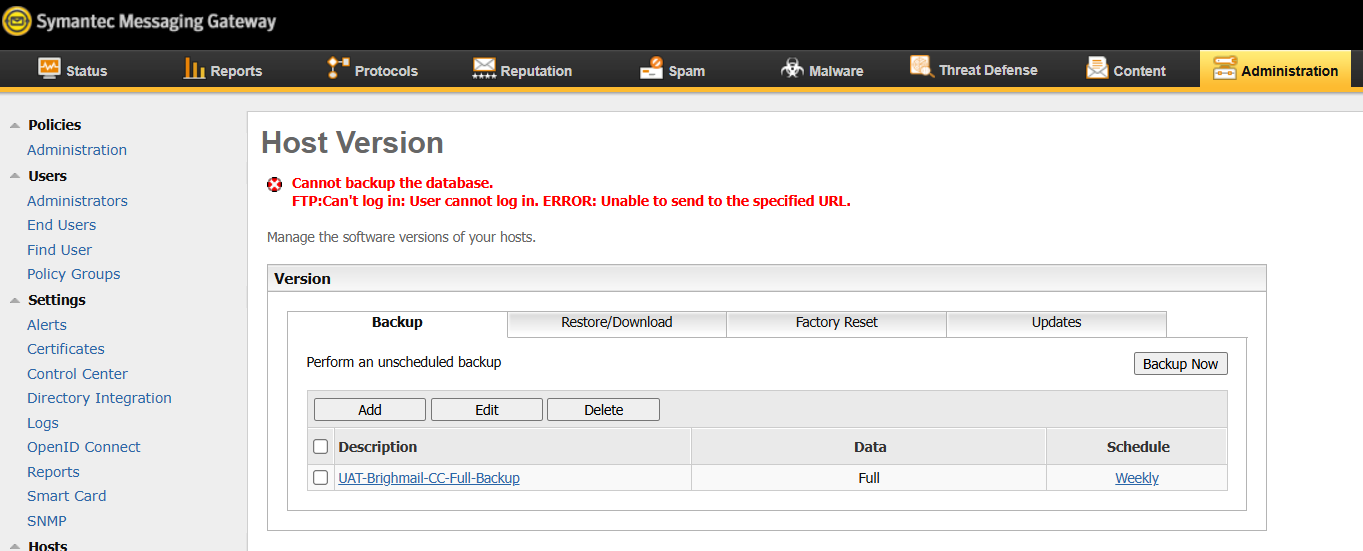

    Hey Everyone.
    We just upgraded our UAT SMG Control Center to version 10.9.1-3, and FTP backup stopped working.
    When we run Backup Now, we get this error.
    Cannot backup the database.
    FTP:Can't log in: User cannot log in. ERROR: Unable to send to the specified URL.
    All the backup settings, the FTP account and password are the same.  We use the  same settings on the Prod SMG Control Center which is still version 10.9.0-3, and FTP backup still works fine there.
    Have any of you run into this problem?
    We have already tried upgrading to version 10.9.2-6, hoping that it would fix the bug, but it didn't.
    Also we have tried to use the workaround described in this article, and it didn't help either
    https://knowledge.broadcom.com/external/article/281550/unable-to-create-the-backup-on-remote-se.html

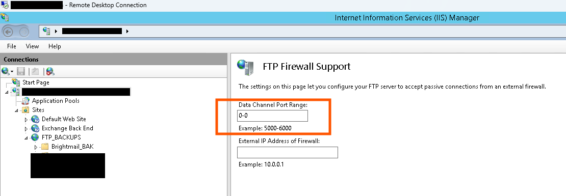

    This article says that the problem could be caused by our FTP server running in PASV mode, but I checked, and our FTP server has PASV turned off, as indicated by the port range 0-0.
    https://knowledge.broadcom.com/external/article/155142/a-backup-of-the-symantec-messaging-gatew.html

    Our FTP server for SMG backups is a Windows server with IIS. How do we enable PASV there?

    Andrey, the first post shows IIS configuration page where you specify ports for ftp to use in case of PASV. You also have to let these ports through firewall. There are also quite many pages on internet when you search something like - iis ftp enable pasv
    For example https://jenkins96.github.io/2024-02-03-Almost-Everything-You-Need-To-Know-About-IIS-FTP-Server/
