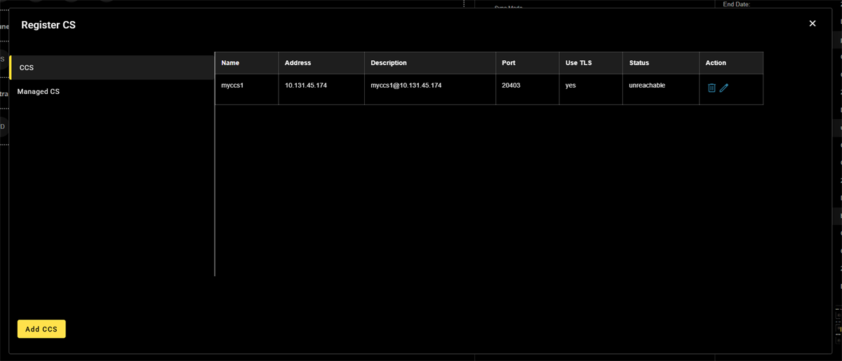

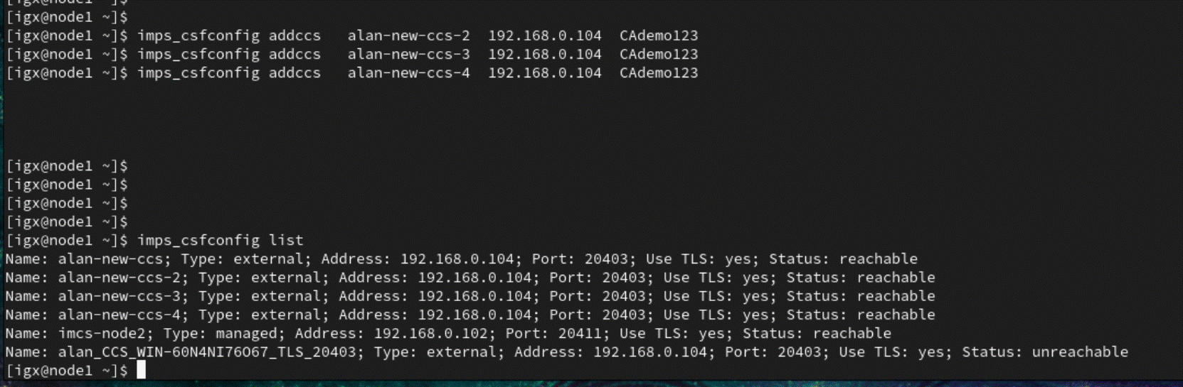

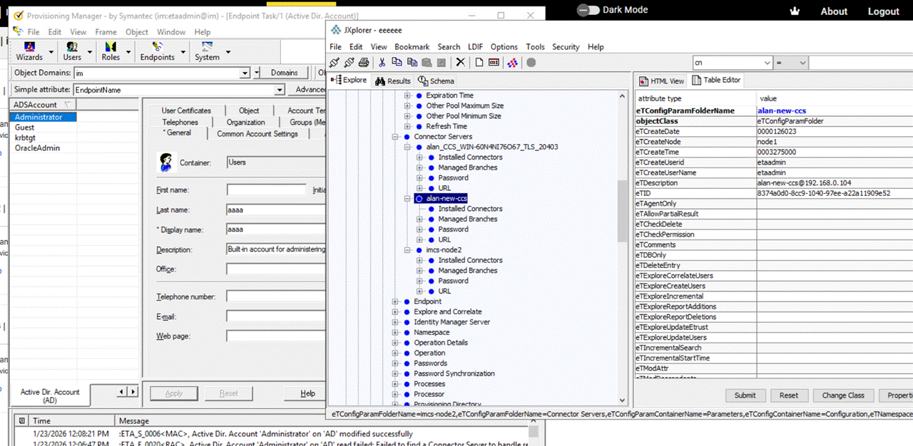

    Rinat,   Excellent work!    Very clear steps to assist with loading an environment.
    The use of the REST interface has shorted deployment considerably with integration to dev-ops processes.
     - We also use an IP REST process to populate the Identity Portal Deployment Xpress package in this new environment.
    I am a fan of the migration of the ccs process integration back into the provisioning server to remove a possible bottleneck.
    The registration process for the ccs process is very straight forward and interesting to view directly in the provisioning directory.
    - It appears all "CCS type" namespaces are auto assigned.
    Is there a roadmap to show the status of the ccs services on the IGA Xpress Dashboad UI, in addition to the JCS (Connector Services)?  e.g. imps_cfsconflg list
    Alan Baugher
    ANA

    Alan
    The dashboard does show the status of CCS.
