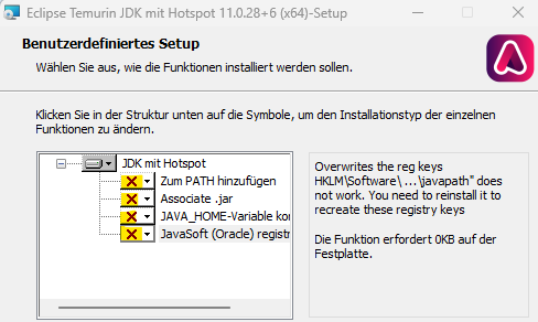

    Installation of the Eclipse JDK
    During the installation of the Eclipse JDK, make sure that your current environment settings are not overwritten.  Thus, when you see the options
    • Add to PATH
    • Associate .jar
    • JAVA_HOME-Variable
    • JavaSoft (Oracle)
    make sure that none of them is activated (see picture).
    Following the installation you can make sure in a Command Prompt, using "java -version", that your previous Java is showing.

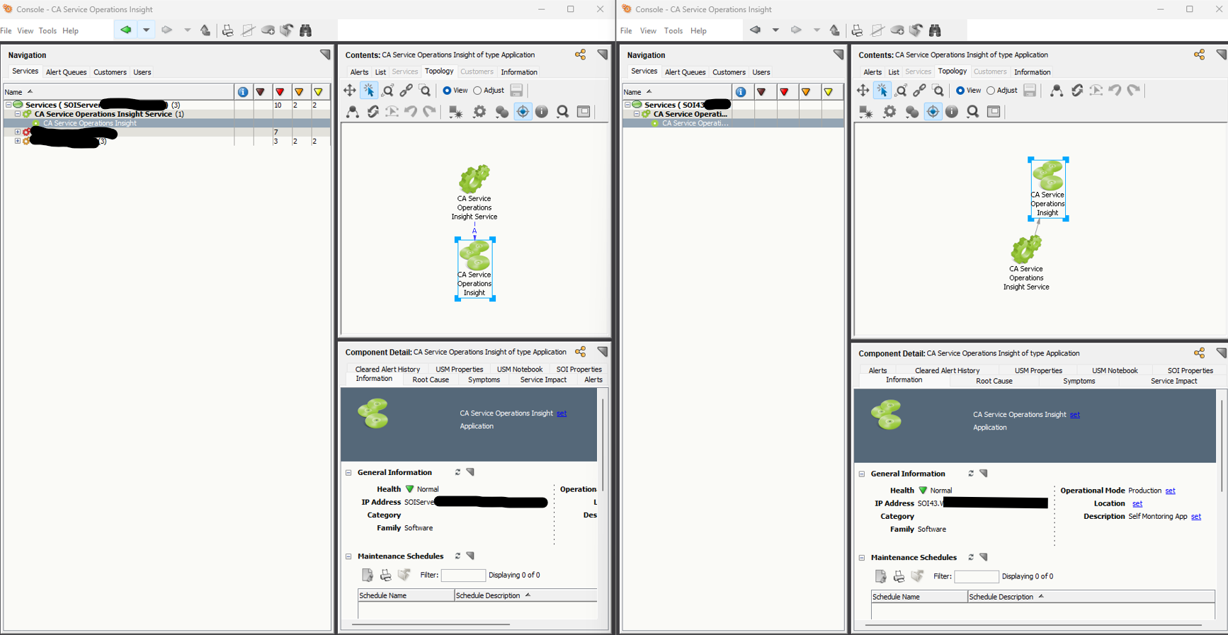

    The OneClick console is started, making use of IcedTeaWeb which is linked to the Eclipse JDK.  Below you see both consoles (to two different SOI systems) in parallel.
    Note: You will see the CMD-Window in background as long as the console is open - don't close it.
