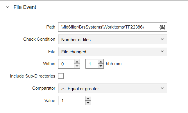

    I did what you suggested.  I added the following script in the Event Process section :
    :SET &HND# = PREP_PROCESS_FILENAME('WIN_WLA-PA1','\\fld6filer\BrsSystems\Workitems\TF22386\*.csv','Y')
    :PROCESS &HND#
    :   SET &LINE# = GET_PROCESS_LINE(&HND#)
    :   PRINT &LINE#
    :ENDPROCESS
    I executed the EVNT.FILE object and then added a file in the folder.  The status of the event stays in checking mode, but there is absolutely nothing in the report. I try adding and removing files from the folder...  nothing !
    This is pretty strait forward.  Can you see what's wrong with this ?
    Here is the content of the File Event section :

    Hmm...  If the event shows a status of 'checking', that suggests to me it's getting hung up on the File Event part of the task, not the Event Process part.
    Some thoughts:
    • If you look at your event executions (or !EVNT executions, if there are any) show anything in their report to indicate what they're doing?  This might be in the Logging report, if there is one.
    • You're not specifying a filename pattern in your path.  Could you try adding '*.csv' at the end to see if anything changes?  (I'm not entirely clear from the documentation whether it's necessary, but it can't hurt to try.)
    • You're using a UNC path, and we've sometimes run into problems doing that if the user you're executing it as doesn't have permissions to the folder.  So first off, on the event's Attributes tab, are you specifying a Login object?  (If no, try adding one.)
      • To further test to see if the UNC path is the issue, could you try testing out this event (or a similar one) against a path on a local drive to see if it behaves properly?
    • I haven't experimented with the 'File changed' setting myself...it's possible that's not behaving the way you expect it to.  In our case, we are typically monitoring incoming file folders, and we use file events like this to kick off workflows to move those files elsewhere, so that the folder we're monitoring is always empty except when new files arrive.  So in this light, we really only need to look for the Number of files >= 1, which is a bit less processing-intensive than what you're specifying here.  (Besides, if you're literally only looking to identify new files in this folder, then the PREP_PROCESS_FILENAME you're using on the Event Process tab may not produce the desired effect, as it will build a complete list of files in that folder, not merely the new ones.)
    Let me know if that helps at all!

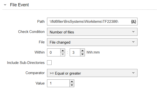

    I modified my script as follow :
    :SET &PATH# = "\\fld6filer\BrsSystems\Workitems\TF22386\"
    :SET &HND# = PREP_PROCESS_FILENAME("WIN_WLA-PA1","&PATH#\*.csv","Y","N",,,"UC_LOGIN=LOGIN.SERVICEACCOUNT.BR.BPMS")
    :PROCESS &HND#
    :  SET &LINE#=GET_PROCESS_LINE(&HND#)
    :  PRINT &LINE#
    :ENDPROCESS
    :SET &RUNID# = ACTIVATE_UC_OBJECT(JOBP.WIN.BR_OA_UTILITY_TEST)
    And the File Event as follow :
    • If you look at your event executions (or !EVNT executions, if there are any) show anything in their report to indicate what they're doing?  This might be in the Logging report, if there is one.  No reports at all.  No information under the Details section either
    • You're not specifying a filename pattern in your path.  Could you try adding '*.csv' at the end to see if anything changes?  (I'm not entirely clear from the documentation whether it's necessary, but it can't hurt to try.)  Tried that !
      • To further test to see if the UNC path is the issue, could you try testing out this event (or a similar one) against a path on a local drive to see if it behaves properly?  I executed another job that writes to that drive and it's working as expected.
    • I haven't experimented with the 'File changed' setting myself...it's possible that's not behaving the way you expect it to.  In our case, we are typically monitoring incoming file folders, and we use file events like this to kick off workflows to move those files elsewhere, so that the folder we're monitoring is always empty except when new files arrive.  So in this light, we really only need to look for the Number of files >= 1, which is a bit less processing-intensive than what you're specifying here.  (Besides, if you're literally only looking to identify new files in this folder, then the PREP_PROCESS_FILENAME you're using on the Event Process tab may not produce the desired effect, as it will build a complete list of files in that folder, not merely the new ones.)  The processed files will be removed from the folder after the job succeeds.  But now I am just trying to get the event to return the file name.
    I don't understand why this is not working !  I added the script in a JOBS.WIN object and it's working (???).  The issue is with the File Event setup...
