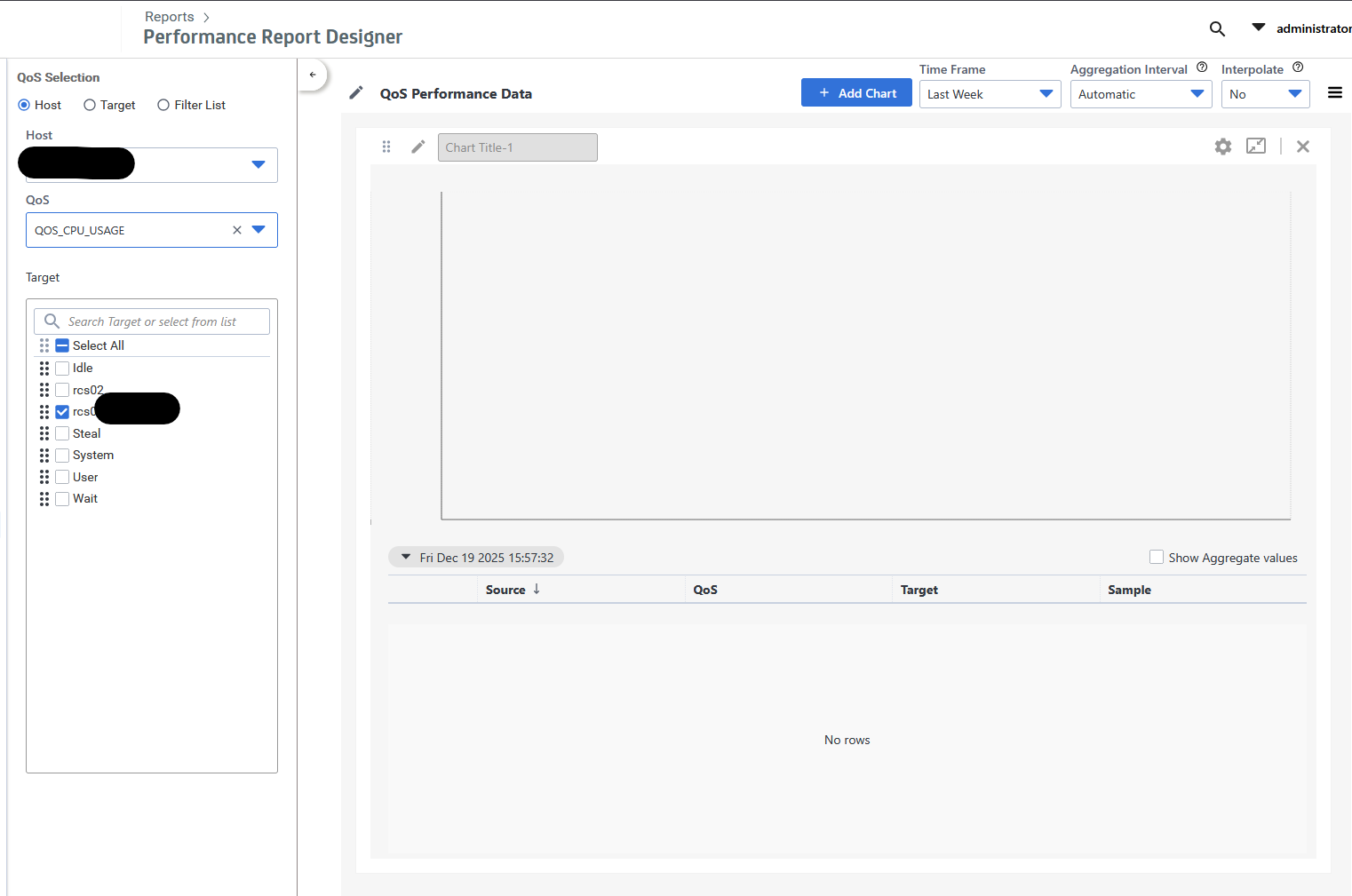

Thanks Sam! For the record, I tested your procedure (briefly) in my CU6 lab system and it returned data. I can't speak to the performance because something is bogging down my infrastructure right now and everything is performing quite slowly to begin with but I can at least confirm that it drew the charts.
Original Message:
Sent: Dec 29, 2025 05:37 AM
From: Sam Green
Subject: PRD Slow Performance

Original Message:
Sent: Dec 29, 2025 05:35 AM
From: Sam Green
Hi Garin,
Attached is the amended SP which resolved the speed issues for us. It has been commented and supplied to Broadcom for review.
Please note, this is for release 23.4.4
Edit, my files doesn't appear to have uploaded...
