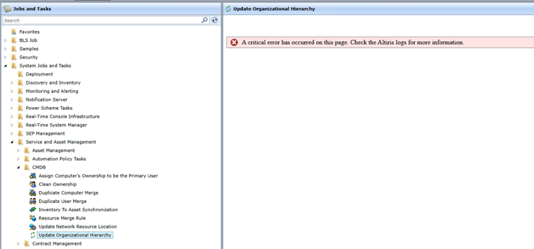

    This error is only seen on a few tasks, for example: Update Network Resource Location, Update Organizational Hierarchy.
    And it happened after upgrading from 8.8 to 8.8.1.
    This is the error seen from the logs. There seems to be issue with page initialization. Any suggestion on how to resolve this error?

    Hi Ain,
    this is now fixed in the May 8 SMP cumulative pointfix: https://knowledge.broadcom.com/external/article?articleId=433118
    Issue itself will be also covered in KB438583 (pending publishing at the moment).
