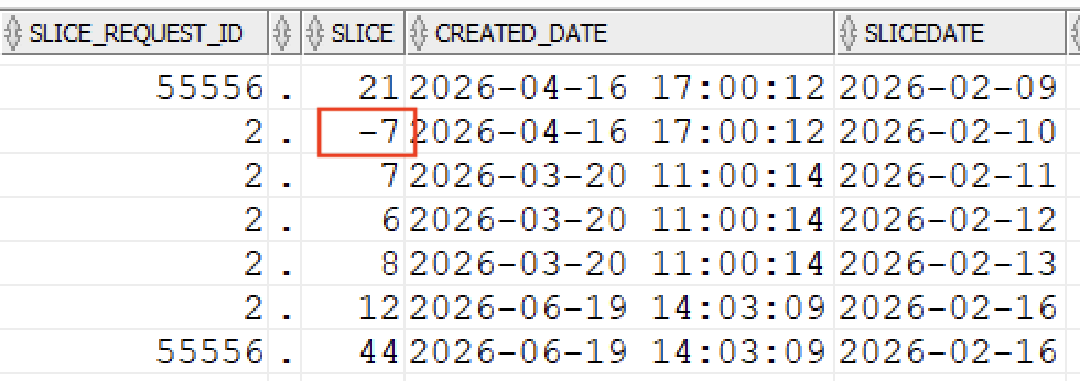

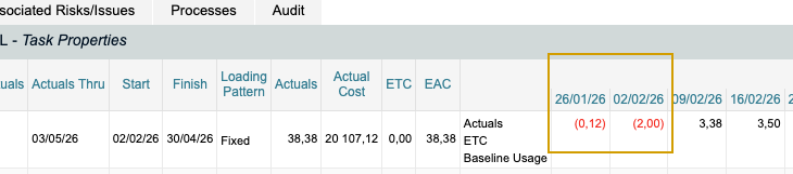

    What can be the cause of having negative values in time slices?
    I can't a functional justification,...
    Can it be the  consecuence of  a database migration? other potential causes?
    See some examples of database and UI

    Daniel, there are some rare cases when negative actuals can happen (Clarity natively does not support negative units), because of imported transactions, adjustments or timesheet adjustments. I see you use financials / have actual cost, I would recommend:
    • checking ppa_wip table to see if the units sum up to a positive amount
    • Compare actuals in the task / assignment record against ppa_wip
    If any disrepancies, might provide pointers to the source of the negative amount.

    The below KB article explains the different scenarios when there can be negative actuals.
    Hope this helps.
    https://knowledge.broadcom.com/external/article/18475/negative-quantity-transaction-entrymanua.html

    Negative actuals usually occur due to a negative-quantity WIP transaction import or a timesheet adjustment, though other data anomalies can also cause this.
    You can use the following troubleshooting queries.
    Identify the Problematic Assignment
    Replace <prj_object_id> with the PRJ_OBJECT_ID from your screenshot.
    -- Replace <prj_object_id> with the PRJ_OBJECT_ID from your screenshot
    SELECT a.prid         AS assignment_id,
           a.prresourceid AS resource_id,
           a.prtaskid     AS task_id,
           a.practsum     AS total_actuals_hrs,
           a.practthru    AS actuals_thru_date,
           a.slice_status,
           a.prstart,
           a.prfinish
    FROM   PRASSIGNMENT a
    WHERE  a.prid = <prj_object_id>;
    Query the Negative Values in Daily Slices
    SELECT s.slice_request_id,
           s.slice_date,
           s.slice,
           s.created_date
    FROM   PRJ_BLB_SLICES s
    WHERE  s.prj_object_id   = <prj_object_id>
      AND  s.slice_request_id = 2
      AND  s.slice_date BETWEEN '2026-01-19' AND '2026-02-28'
    ORDER BY s.slice_date;
    Check the Timesheet Entries for this Assignment
    SELECT te.prid           AS time_entry_id,
           te.prtimesheetid,
           te.practsum       AS entry_actual_hrs,
           te.slice_status,       -- non-null means curve needs re-slicing
           te.prrmckdel,          -- 1 = marked for delete (recall scenario)
           te.prmodtime
    FROM   PRTIMEENTRY te
    WHERE  te.prassignmentid = <prj_object_id>
    ORDER BY te.prmodtime;
    Check for Negative WIP Transactions
    -- Join via EXTERNALTRANSNO on PRTIMEENTRY.PRID or filter by investment/resource
    SELECT w.transno,
           w.transdate,
           w.quantity,
           w.resource_code,
           w.project_code,
           w.task_id,
           w.sourcemodule,
           w.status
    FROM   PPA_WIP w
    WHERE  w.investment_id = <project_id>
      AND  w.transdate    BETWEEN '2026-01-19' AND '2026-02-28'
      AND  w.quantity     < 0
    ORDER BY w.transdate;
    Review the following KB article to understand the steps to fix the negative actuals. Feel free to reach out to Broadcom support for any help on this.
    https://knowledge.broadcom.com/external/article?articleId=18475
    Thanks,
    Sravani
