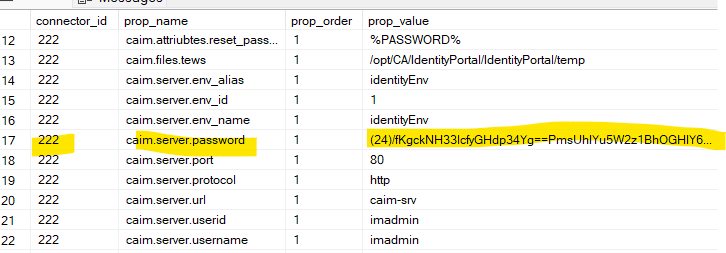

    I have found out that my existing sigmadb(which is r14.5), is created with caim_connector_id=222.
    and the new sigmadb(r15), is created with caim_connector_id=242
    If IdentityPortal(idp) datasource directly point to sigmadb(r14.5), then the caim_connector would not startup & return error.
    So, i exported my new sigmadb(r15)'s caim_connector to json file.
    Then on my new IdentityPortal r15, import this caim_connector(r15) and overwrite it and then caim_connector able to startup without error.
