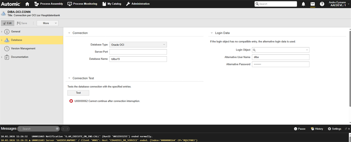

    We are attempting to set up a Connection object to access an Oracle database, but unfortunately, the process keeps failing.
    Database Type: Oracle OCI
    Service Name: Discovered through TNS_ADMIN on the Automic engine server (Linux)
    Hint: We can successfully connect to the desired database using SQL*Plus on the engine server.
    The Problem:
    When clicking "Test" in the Connection object, the following error appears: "Cannot continue after connection interruption." Additionally, the DB Service agent shuts down (!).
    For context, the agent's INI file contains the entry useOraClient=1.
    Can anyone help us resolve this issue?
    Failed connection to Oracle Database

    I fixed this using "Generic JDBC" as Database type and providing an JDBC connect string within Server:Port.
