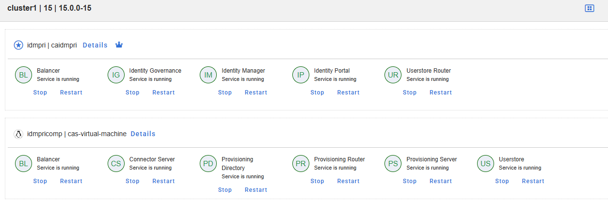

  • 3.  RE: IGA 15.0
    Posted Sep 05, 2025 03:50 AM
    Hi,
    We attempted to migrate from VApp to v15, but ran into an issue. All services have started, but we are unable to log in to Identity Manager. When trying to log in, it shows an "Internal Server Error."
    I have already raised a support case (ID: 80035244), but it usually takes months before the actual problem is addressed. Maybe you can help.

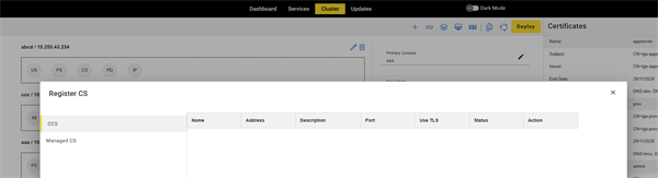

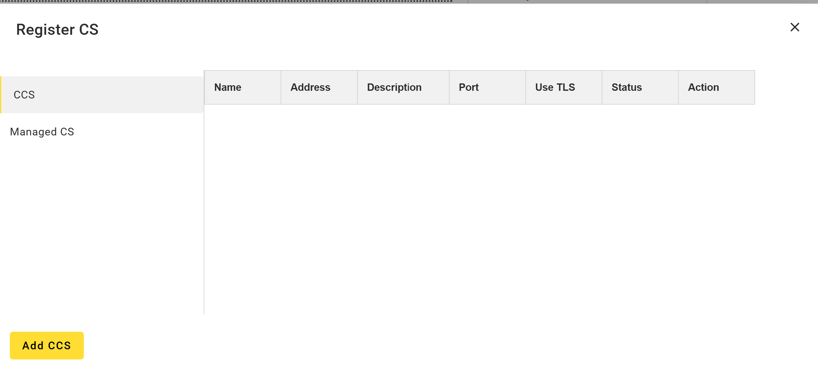

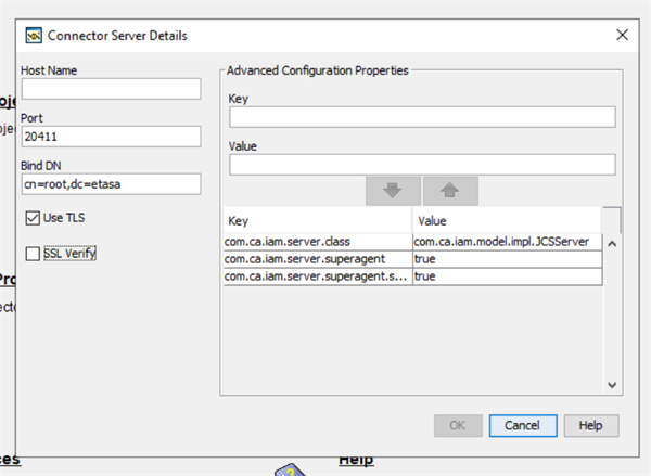

    Sudip
    For adding CCS via ConXP, you must do one of the following
    1. Establish trust in ConXP trust-store. See import cert in https://techdocs.broadcom.com/us/en/symantec-security-software/identity-security/identity-manager/15-0/configuring/use-custom-certificates/Connector-Xpress.html
    2. You can disable SSL-verification. There is a SSL Verify option that you can uncheck.
    Instead of using ConXp, The IGA Xpress console has the facility to register CCS.
  • 6.  RE: IGA 15.0
    Broadcom Employee
    Posted Sep 19, 2025 01:53 AM
    Edited by Laxminarayana Namani Sep 19, 2025 05:30 AM
    Hi Sudip,
    We can manage IMCS(JCS) using Connector Xpress but not CCS. Please use igx console to register CCS.
    Thank you.

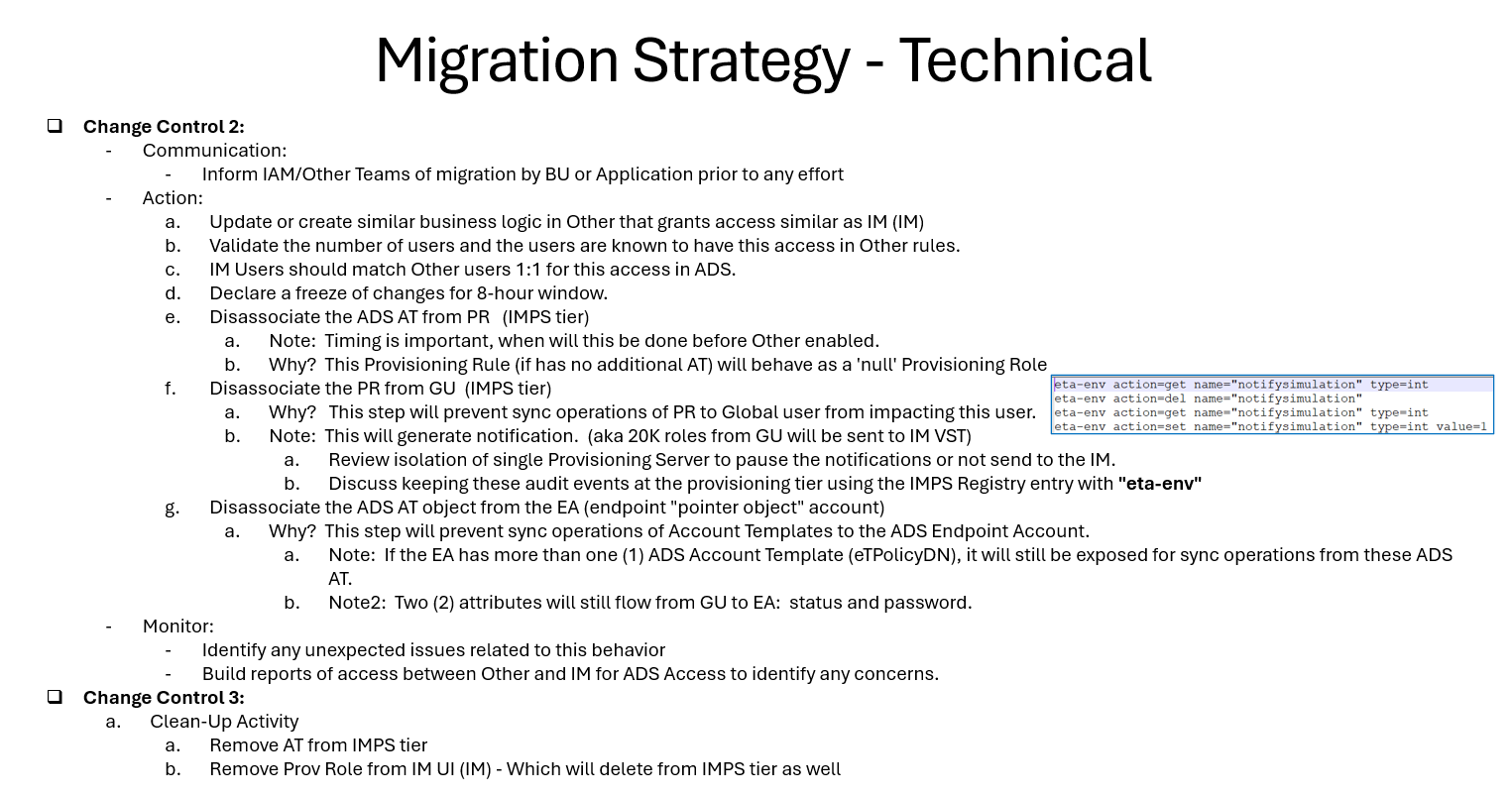

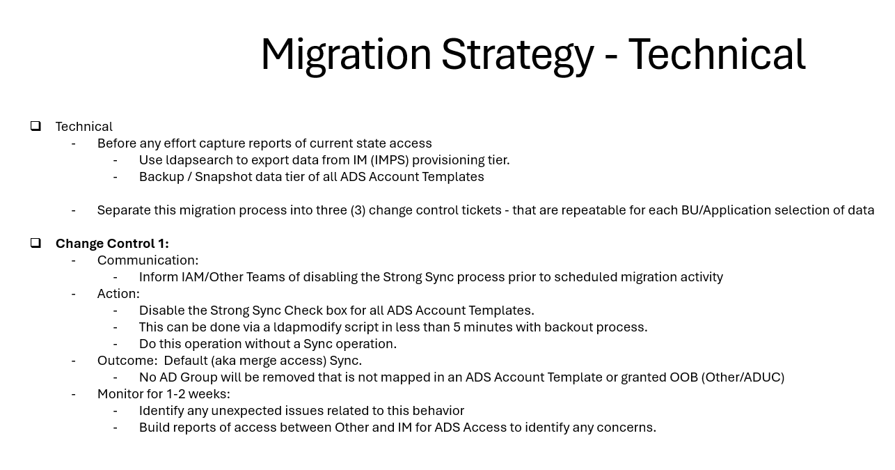

  • 7.  RE: IGA 15.0

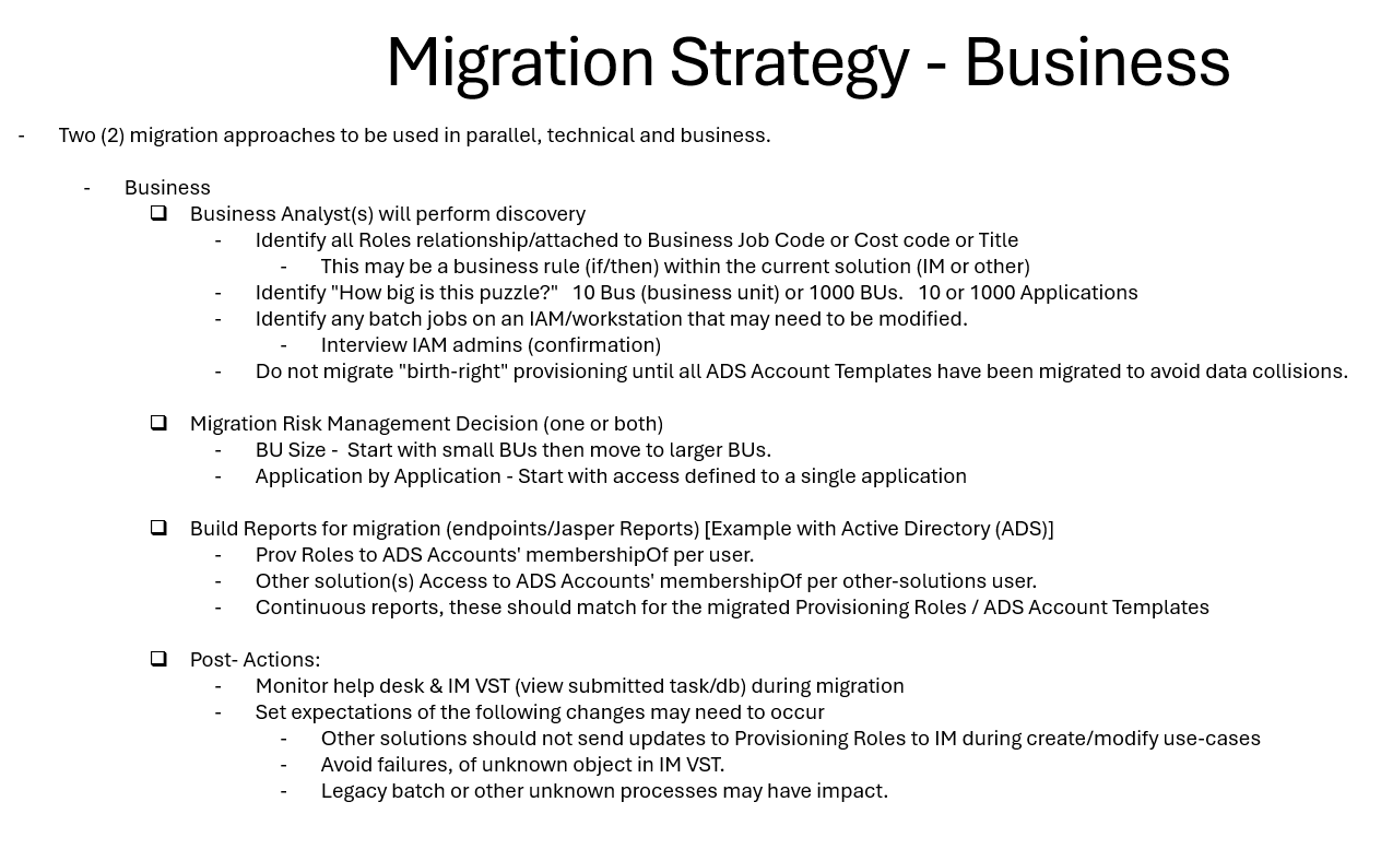

    Posted Sep 12, 2025 02:23 PM
    Hi Adrian,
    I always approach these migrations as an opportunity to reduce complexity and streamline processes.
    Business processes are always updating, and it may be beneficial to retire or replace older processes while performing this effort.
    Unfortunately, the automation tools may move current configuration/data AS-IS and miss the steam-line opportunities.
    Example of some migration guidelines we have:
    Wish you the best.
    Alan Baugher
