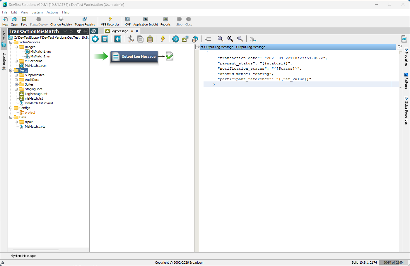

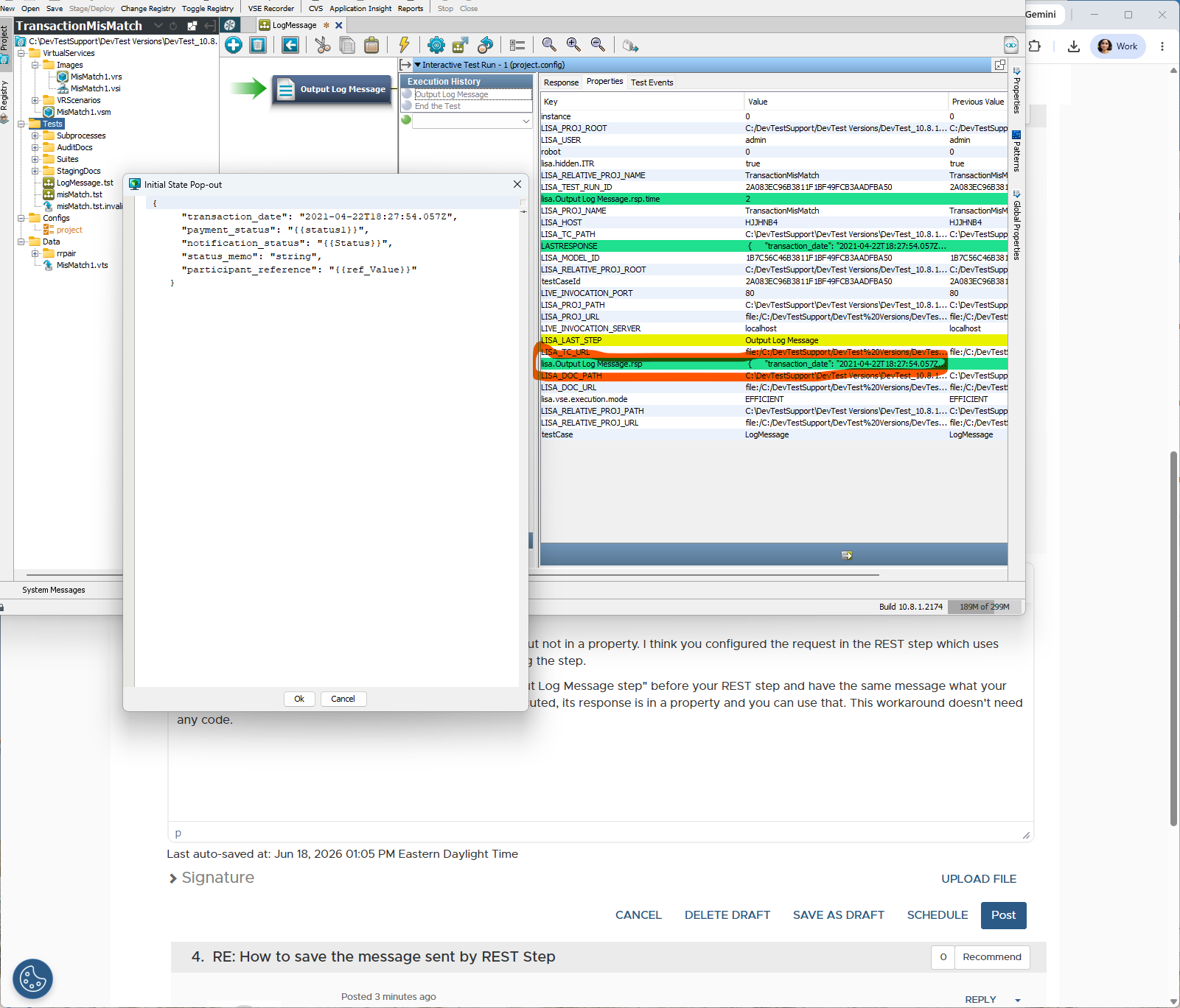

  • 5.  RE: How to save the message sent by REST Step
    Broadcom Employee
    Posted Jun 18, 2026 01:13 PM
    Hi Rajasekhar,
    The request sent by the REST step is in Step Request Event but not in a property. I think you configured the request in the REST step which uses some properties from your VS and evaluates before executing the step.
    As the request is not stored in a property, you can use "Output Log Message step" before your REST step and have the same message what your REST step has. When the "Output Log Message step" is executed, its response is in a property and you can use that. This workaround doesn't need any code. See the below screenshots.
    Hope the information helps.
    Regards,
    Prema
  • 6.  RE: How to save the message sent by REST Step
    Posted Jun 18, 2026 02:50 PM
    Thank you Prema. it worked.
