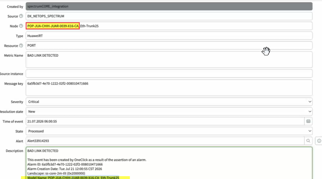

    Hi, team
    Alarms originating from interfaces are standardized to include both the device name and the interface name; however, the ServiceNow integration requires that the "node" field contain only the device name, while the message itself displays the combined device and interface identification. This enables proactive identification of the faulty device within ServiceNow, while allowing us to pinpoint the specific interface in the description.
    In the attached image, I have highlighted the relevant fields in yellow; the "node" field should contain only the equipment name for interface alarms, and the "message" field should show the standardized device-plus-interface designation.

    I would say you'd need to customize the integration and not use the default one.  Customizing allows you to use SANM and AlarmNotifier to filter/create custom actions for specific needs. I think with the default integration the sent object will always be ModelName. That is the attribute that is sent over to SNOW.
    I would create a custom AlarmNotifier instance and for each bad link link alarms could use the Device_Mdl_Handle(0x10069) to identify relevant device name and use it in the call to open/close/update the tickets on the SNOW part.

    Hi
    Our integration to SNOW is a custom integration using SANM/AlarmNotifier and we had the same issue as you describe for BAD LINK alarms. We solved very easily in the set and clear scripts by stripping everything from the last _ in the model name for BAD LINK alarms.
     if [ $CAUSE = "1040a" ]
       then
         TEMPMNAME=${MNAME%_*}
         MNAME=$TEMPMNAME
    fi
    We use MNAME as the CI name in the Rest call to SNOW.
    I'm sure this or something similar should work for you.
