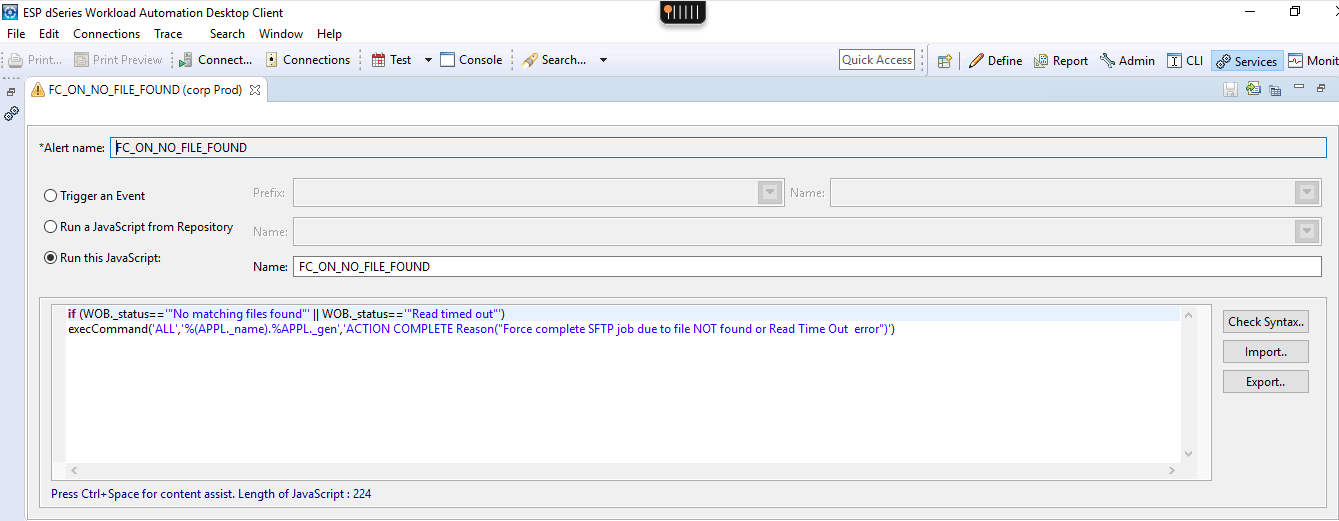

    The Issue: For cases like "No matching files found" or "Read timed out", the job goes to FAILED briefly and then force-completes automatically within a few seconds (due to Alert setup in Notifications/Service perspective).

    • We tested WOB._status but it works only for Alerts.

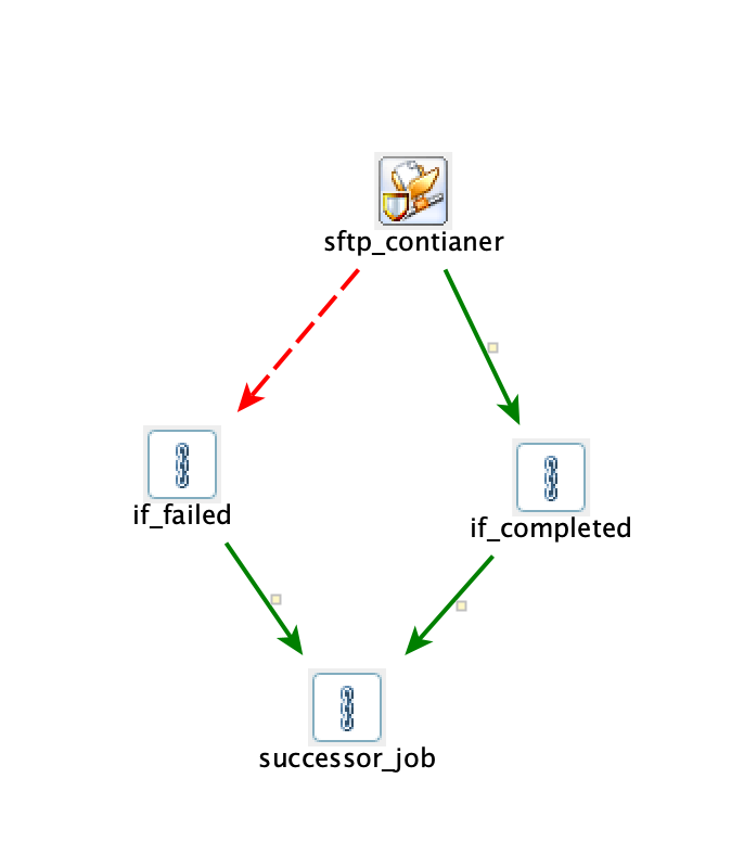

    You can setup two link jobs.  One will release on failure, and another on success.  Then link jobs then connect to your successor jobs.  Here is screenshot for the jobs, see if that helps.   You can setup your Javascript in the link job based on fail or completed.
    SFTP
    HTH,
    Nitin Pande

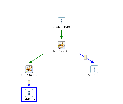

    However, we created a link job for each SFTP job to handle notifications. The link job runs only if the SFTP job has failed (exit code 1). The link job is configured with a 1-minute delay:
    - If the SFTP job is force-completed within that minute, the link job does not run.
    - If the SFTP job is still in FAILED state after 1 minute, the link job runs and completes, sending a notification email (PagerDuty alert) that the SFTP job FAILED.
    We also had setup another Alert in the services perspective - added in the SFTP job. If the SFTP job succeeds (Completed or Force Completed by the previous Alert), this new Alert ensures that the link job is force-completed successfully, preventing false failure notifications.
    We've tested the approach, and it's working as intended.
