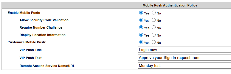

    1. Firstly, does VIP support registration of multiple devices under 1 ID ?
    2. Will the Push authentication works on both Android and Apple mobile phone ?

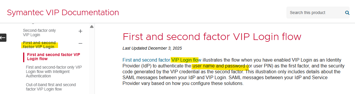

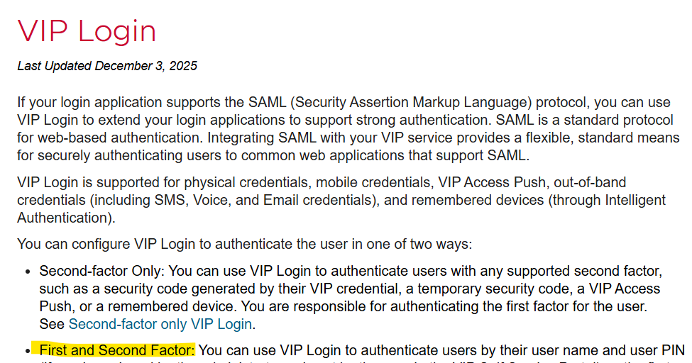

    Customer want SAML integration with BeyondTrust. Since using SAML, Idp will be VIP(Sp will be BeyondTrust). When access BeyondTrust Portal, click on Login button, it will redirect to VIP page to prompt -> AD Username + AD Password (1st factor) and 2nd factor to be handle by VIP(Push or OTP). Based on what u have explain, this is NOT possible ?
    For VIP, only Radius Auth/integration can handle such flow ?
    In techdoc on VIP Login, mentioned authenticate username & password, so this VIP username & password,
    it is NOT refer to AD username & password ?
    regards,
    William

    Thanks for your advice on the VIP(Saas) Login SAML Idp only work on VIP username & VIP Pin.
    I would like to provide my feedback on this:
    • where "VIP(Saas) Login SAML Idp only work on VIP username & VIP Pin and does not support LDAP auth" it should be listed in VIP Techdoc as limitation(If Product team does not have plan to enhance).
    • It is common for other IAM product, where SAML Idp able to support LDAP Auth as 1st factor. The VIP(Saas) Login Idp should be enhance to support LDAP Authentication. Since the MyVIP Idp(on EG) & Self Service Idp(on EG) is able to support LDAP authentication.
    • With the above enhancement(VIP Login SAML-Idp support LDAP auth), If customer is looking for simple IAM solution with SAML Idp, then VIP(Saas) is a good fit else if customer want a more complex IAM then we can suggest the VIP AuthHub.

    > SAML (less common) or the SSO is configured for SAML for step-up
    > authentication with Symantec VIP (more common).
    > With VIP Enterprise Gateway, it can be tied to an LDAP server (AD) to
    > verify that the user is in AD, or in a particular group, or even other
    > LDAP-queryable configurations as well. VIP Enterprise Gateway will
    > dutifully check the AD password before sending the (now verified AD
    > username) and the VIP factor up to Symantec VIP for validation (Push, OTP,
    > OOB, etc.) For this to work with BeyondTrust, BeyondTrust would need to
    > support RADIUS. If they support RADIUS in PAP-mode (one of the most common
    > integration methods), then it should work.

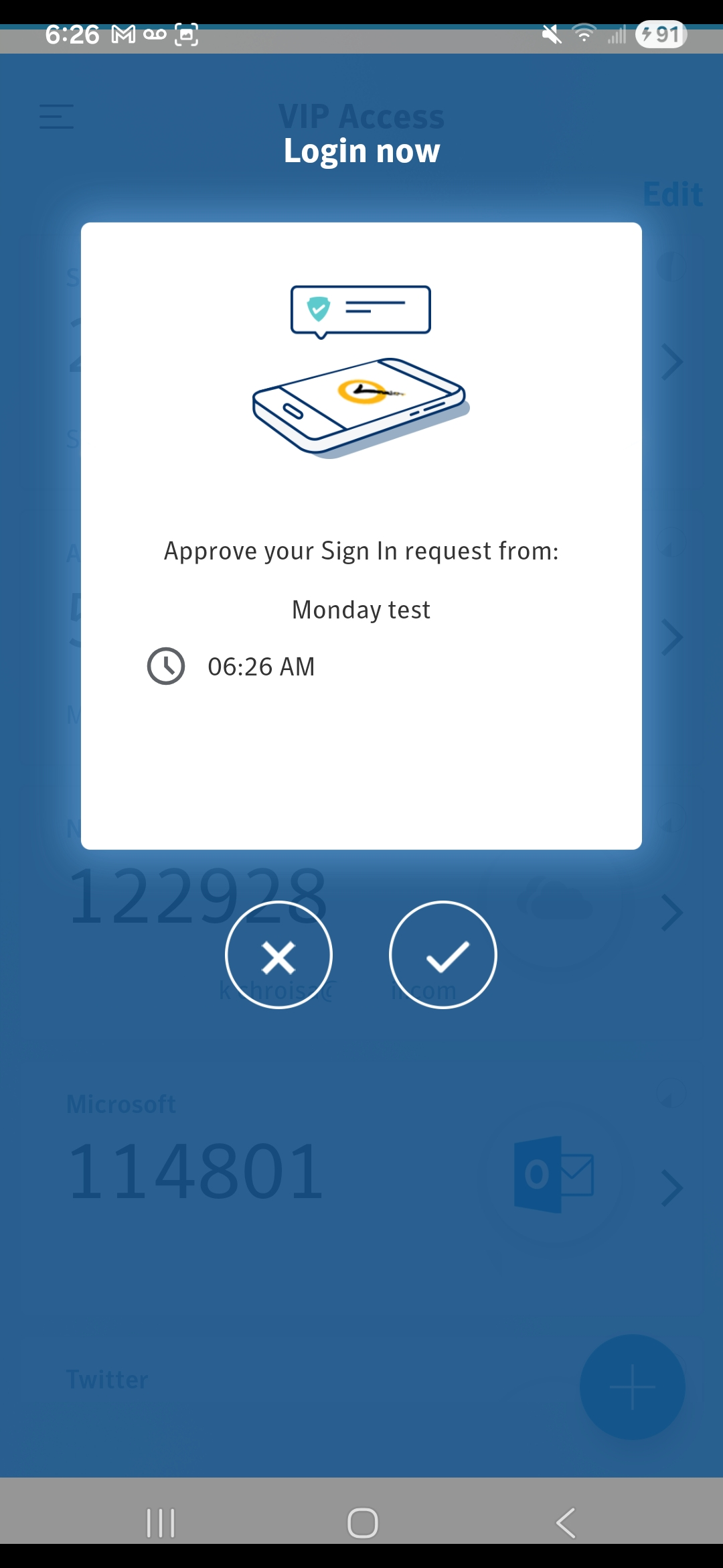

    As for the questions: Symantec VIP supports up to 5 credentials per user id.  VIP Push authentication works on both Android and Apple platforms.  In fact, there are some additional options with Push that might be worth investigating: Number Challenge and Location context.  Both of these are configured in VIP Manager under Policies -> Account -> Mobile Push Authentication Policy:
    Additionally (and new) is the possibility of changing the text that displays in the VIP Push (as customized above).  On the credential, it looks like this:
    While we don't have a specific integration guide for BeyondTrust, our general documentation around VIP Login (our SAML authentication feature) may be helpful in this process:
    https://techdocs.broadcom.com/content/dam/broadcom/techdocs/us/en/dita/symantec-security-software/identity-security-authentication/vip/generated-pdfs/VIP_Login.pdf
