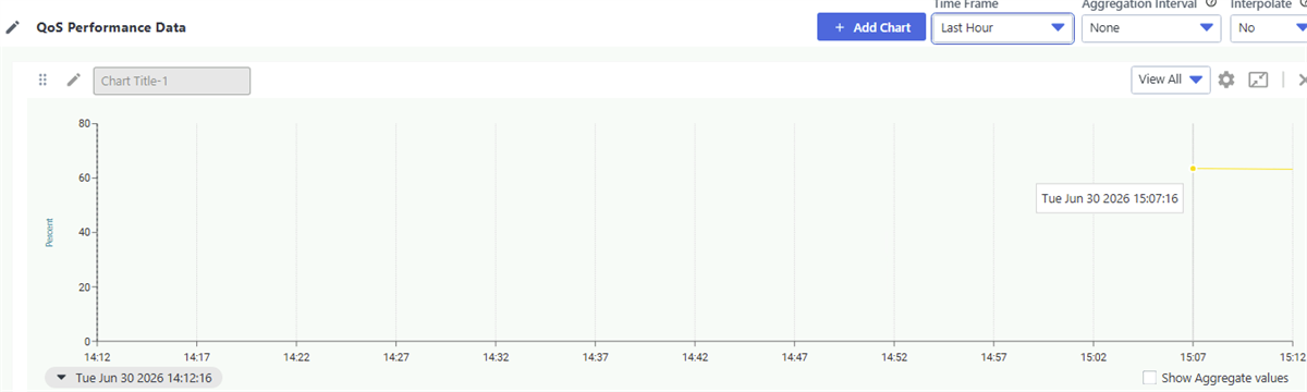

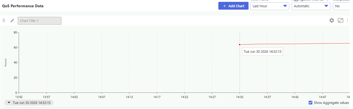

  • 4.  RE: CU8 QoS Retention Issue
    Posted Jun 30, 2026 11:48 AM
    Thanks Joakim,
    I ran some tests by setting data_engine to run during the day so I could watch it.  Sure enough, it loses all QoS prior to the schedule I set.
