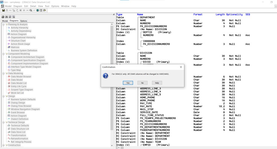

    From a Gen perspective to avoid encountering any problems we would normally advise to have the attribute format defined in the Data Structure List (used to generate code) matching the target database column type which it will be by default if Gen is used to also generate the DDL of course.
    To assist with a mass CHAR to VARCHAR2 conversion, there is a "To VARCHAR2" feature that enables quick conversion of all CHAR format attributes to VARCHAR2. See Edit in Data Structure List.
    Example screenshots below.
    I did do a quick generated code test for ORACLE targeting C and C# (.NET) before and after using "To VARCHAR2" on a copy of the sample model.
    In Window Code Generation generating for DBMS (TD)=ORACLE:
    • For C, the generated MODEMP.sqc file for MODIFY_EMPLOYEE did change from "static char" to "static VARCHAR".
    • However for C# (.NET that you will be using) the generated code did not change. The code does show the information about whether the field is defined as varying length or not. All the EMPLOYEE entity text attributes are actually fixed length and only when I changed one to varying length did the generated code for C# change. (This difference to C probably relates to the way a C# application would be connecting to ORACLE via ADO.NET at runtime and there is no precompile done at build time.)
      So it appears using "To VARCHAR2" would not help for C# generated code.
