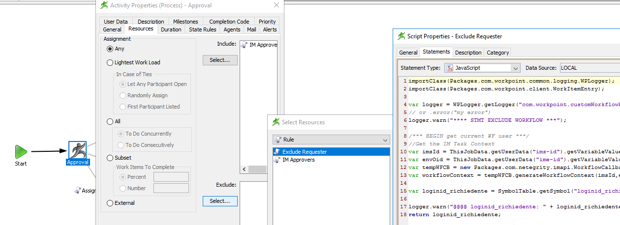

    I am currently developing a new solution in Broadcom Identity Manager 14.5, specifically a solution that leverages your Workpoint technology for workflows.
    In practice, the client has asked me to add logic to the workflows so that a user cannot be both the requester and the approver of a role at the same time. For example, if I request a role for myself, then I must be removed from the list of possible approvers.
    Unfortunately, there is no out-of-the-box configuration in Broadcom Identity Manager that provides this functionality, so I need to create it myself to meet my client's needs.
    My plan is:
        1. Create a support table in the Broadcom Identity Manager database
        2. Write the requester's user ID to this table every time a new workflow task is started (along with other information such as task ID, timestamp, etc.)
       3. From the Workpoint, in the process where I want to add my logic, I double-click on "Activity Properties (Process)" > Resources tab > select Any > in Exclude, I select "Select" > I create a new Script containing two statements:
            I. an SQL query to retrieve the user ID from the support table in step 1
        II. JS code to return the user ID of the user who must be excluded.
    However, the Workpoint does not exclude that user ID from the approvers. In practice, the workflow proceeds normally to all possible approvers (including the requester), but from Identity Manager it is not possible to approve the request, and the logs do not show errors, but this:
    Where am I going wrong? Is it possible to get support on this?
    Here is the JS code:
        importClass(Packages.com.workpoint.common.logging.WPLogger);
          importClass(Packages.com.workpoint.client.WorkItemEntry);
        var logger = WPLogger.getLogger("com.workpoint.customWorkflow");
        // or .error("my error")
        logger.warn("**** STMT EXCLUDE WORKFLOW ***");
          /*** BEGIN get current WF user ***/
        //Get the IM Task Context
        var imsId = ThisJobData.getUserData("ims-id").getVariableValue();
        var envOid = ThisJobData.getUserData("ime-id").getVariableValue();
          var tempWFCB = new Packages.com.netegrity.imapi.WorkflowCallbackHelper();
        var workflowContext = tempWFCB.generateWorkflowContext(imsId, envOid);
        var userid_requester = SymbolTable.getSymbol("userid_requester").getPrimaryValue();
          Logger.warn("@@@@ userid_requester: " + userid_requester);
    I also tried adding a "return true" or a "return userid_requester" after the last line, but without success
    Thank you so much for everything
    Greetings
    Andrea

    Hi Andrea
    Consulting with local SMEs, the way to achieve this requirement is simpler (without the need to use of an external DB) -  is by creating  a custom participant resolver (implementing ParticipantResolverAdapter).
    The Participant Resolver is capable of identifying the requester as well as remove that requester from the list of resolvers that are returned in the resolve method.
    This way, no external DB is required.
    Hopefully this provides with a good starting point.
    Regards
    Rinat
