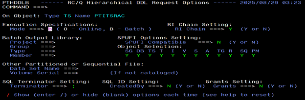

    Example 1: Running RC/Query Hierarchical DDL
    You may want to generate a DDL for particular Db2 objects. For example, for a table space and its related objects (known as a hierarchical DDL). If you use RC/Query, you can generate a hierarchical DDL report (HDDL) in ISPF or in batch. By capturing the generated JCL and input from the generated batch job, you can create a Unix script to run the job from the Unix shell.

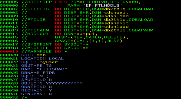

    Let's see how to navigate through ISPF to generate the HDDL JCL.
    Once you know the JCL and syntax, you can create a shell script that users unfamiliar with the ISPF interface can invoke.
    For example, the following Unix script (hddl) is based on the generated JCL and customized to take the database and tablespace name as input:
