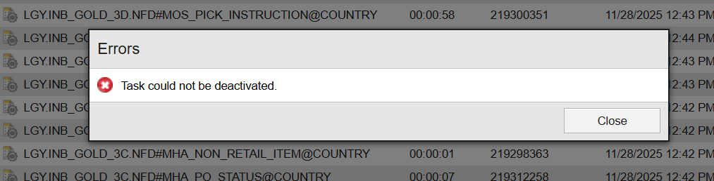

  • 3.  RE: Automic schema tables
    Posted Nov 28, 2025 04:51 AM
    Hi Marcus,
    Thanks for your valuable response!
    We have some issues while clearing the deactivate tasks from process monitoring perspective, we are trying to clear it manually, but it is not clearing. And we are maintaining the ILM partition and dropping it in timely manner.
    Kindly suggest if we can take any other action on this issue, as you mentioned we are having some challenges on application.
    Regards,
    Shravya
  • 4.  RE: Automic schema tables
    Broadcom Employee
    Posted Nov 28, 2025 05:01 AM
    Hi Shravya,
    please switch the view in process monitoring from list view to tree view and look for top level workflows. then deactivate those top level workflows. It will also deactivate the tasks within those workflows. Start with oldest workflow tasks first.
    When using ILM make sure you still run the Reorg and Unload utility in order to get rid of objects in the recycle bin and to reorganize versioned objects.
    ILM partitions cannot be checked and dropped if related activities are not deactivated in process monitoring.
    If it turns out there are too many tasks left for deactivation open a case with Support and ask for help cleaning up the tables.
    Regards, Markus

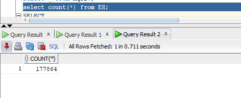

  • 6.  RE: Automic schema tables
    Broadcom Employee
    Posted Dec 04, 2025 01:47 AM
    Hi,
    based on the information provided I think the data you are seeing reflects the data being generated at normal workload of your Automic instance. But I am not able to verify that based on that data. Your queries are showing EH for a couple of specific dates, but the other E-tables show the total number of records. All other tables are child-tables to EH. How many days/weeks (how many ILM partitions) you keep in you DB?
    Regards, Markus
  • 7.  RE: Automic schema tables
    Posted Dec 04, 2025 08:23 AM
    Hi Markus,
    We usually keep 14days of data in DB (3 sets of ILM) and clear remaining. EH table also is not having much data.
    Need to know how the EJ** and some other tables having more data, how that can be cleared?
    Regards,
    Shravya Devadiga
  • 8.  RE: Automic schema tables
    Broadcom Employee
    Posted Dec 04, 2025 09:01 AM
    Hi Shravya,
    please provide the following output:
    select count(*) from ev where ev_ah_idnr not in (select eh_ah_idnr from eh);
    If the count is 0 then it means all the records in the EV table belong to current tasks in the Process Monitoring. If the count is > 0 then there are orphaned records (please open support case and ask for clean-up SQL statements).
    Regards, Markus
