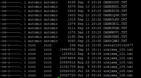

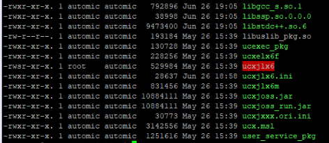

    Normally, we have been setting the SUID bit (s-bit) and root ownership on the ucxjlx6 file for many years without any issues. This has been our standard configuration.
    After upgrading to Agent 24.4.4 HF2, we noticed that the temporary log files created by the agent are now owned by root. As a result, we are unable to read these logs with the expected agent user permissions.
    With earlier agent versions, under the same configuration and permission model (SUID bit (s-bit) and root ownership ), the temporary log files were owned by the Automic agent user, and we did not experience this issue.
    It seems that something may have changed in this 24.4.4 HF2 version regarding log file creation or ownership handling.

    • at least with Version 24 the agent needs to run with java. As far as I can remember, the upgrade to a java based agent version was not possible with CAU, so you might have installed the agent manually or with a script, at some point running with root privileges. Perhaps the last step in that procedure was to start the agent (without restarting or triggering the servicemanager) and that was done by root?
    • check your systemctl script and the owner of the servicemanager files. The servicemanager binaries should be owned by your automic user for the agent to run under that user.
