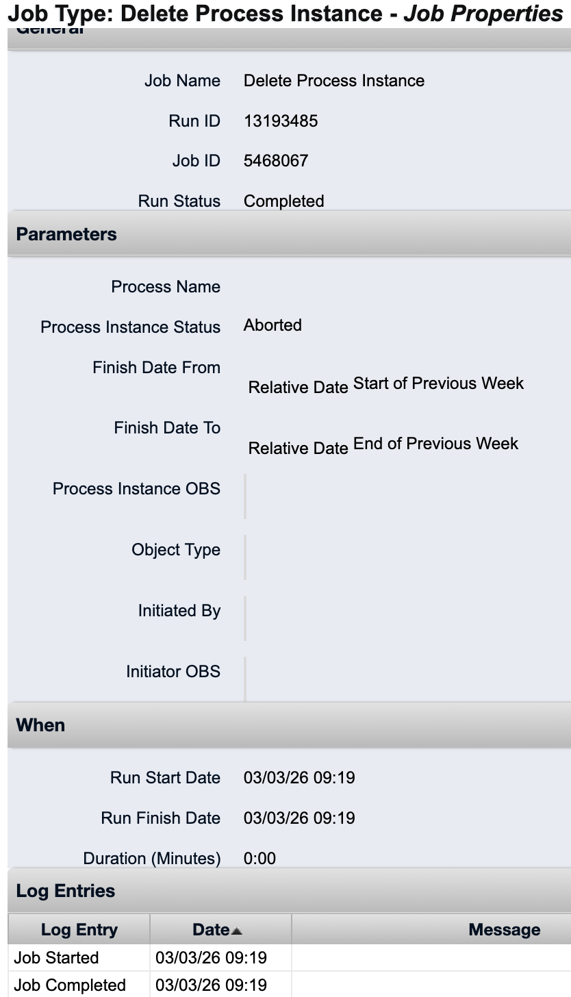

    the job "Delete Process Instance" with filter parameters is neither cleaning aborted or done.
    I've tried with different filters, and at least:
          process name+status+range of specific dates, status+range of specific dates,status+range of relative dates
    Is/was there any bug in this job for certain parameters?
    The jop gets executed without error but no a single process is deleted.
    The job definition has enabled logs, Should be written logs in the server?

  • 5.  RE: Automate the selection of processes for cancel/delete
    Posted Mar 03, 2026 04:16 AM
    Edited by Daniel Perez Gonzalez Mar 03, 2026 05:38 AM
    yes, I tried several combinations and always with days inside the filtered period.
    Regarding the filter in the screenshot capture, there are aborted processes started on  days 23,25,26 but not deleted yet

  • 7.  RE: Automate the selection of processes for cancel/delete
    Posted Mar 03, 2026 05:53 AM
    Edited by Daniel Perez Gonzalez Mar 03, 2026 09:35 AM
    This test among many others were already done without success.
    Anyway I've just realized that filters are related to "Finish" dates and not "Start" dates (as i was expecting).
    In brief for aborted instances of a process is all or none so, the job is working "as expected".
  • 8.  RE: Automate the selection of processes for cancel/delete
    Posted Mar 09, 2026 02:50 AM
    Daniel, that is correct and we can confirm that is the behavior. What we tend to recommend organizations is a job for aborted instances and another one for completed ones with a date range
