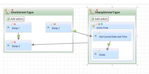

1- Have two server type "OneServerType" with just one agent and "ManyServerType" with many agents.
2- Have a simple process shown below which span across both server type.
Note: The above process has a loop between the server types from OneServerType à ManyServerType àOneServerType

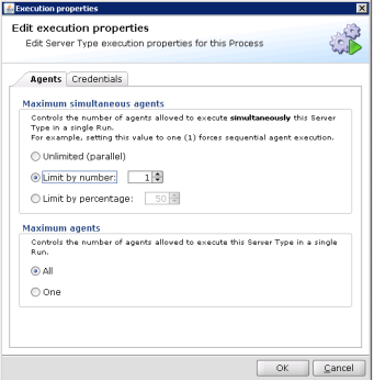

3- Right click on OneServerType and select "Execution Properties"
4- Under Maximum simultaneous agents select limited by number and set it to 1 : This means that how many agents can run in parallel irrespective of server type they belong to
5- Now try to publish the process and It will throw the cyclic dependency error.
Resolution: Don't limit the number of "Maximum Simultaneous Execution"
