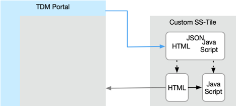

A custom Self-Service Tile enables TDEs to write custom code that will be consumed by CA TDM Portal and displayed in the self-service catalog. This code is essentially HTML and JavaScript.
CA TDM Portal displays the HTML form and engages the JavaScript controller with the form. Every aspect of the UI and the controller should be coded. CA TDM’s REST APIs can be leveraged from the JavaScript as well to maximize the potential of the CA TDM Portal.
CA TDM does not impose any sort of validation on the custom code and hence not responsible for functionality, security, performance or any other aspect.
Custom Tile Basics
CA TDM Portal Scans the “subdirectories” in the location:
“~\ProgramData\CA\CA Test Data Manager Portal\ssforms\~”
It scans and looks for a JSON file named – “ssform.json” – A file that species details of the custom form.
This JSON file specifies a HTML file name and a JavaScript file names.
The .JSON file, .HTML file and .JS files must be in the same directory and this directory must be created under the “~\ssforms” directory.
Multiple subdirectories can be created and for every valid ssform.json in these subdirectories a custom self-service tile will be displayed in the self service catalog.

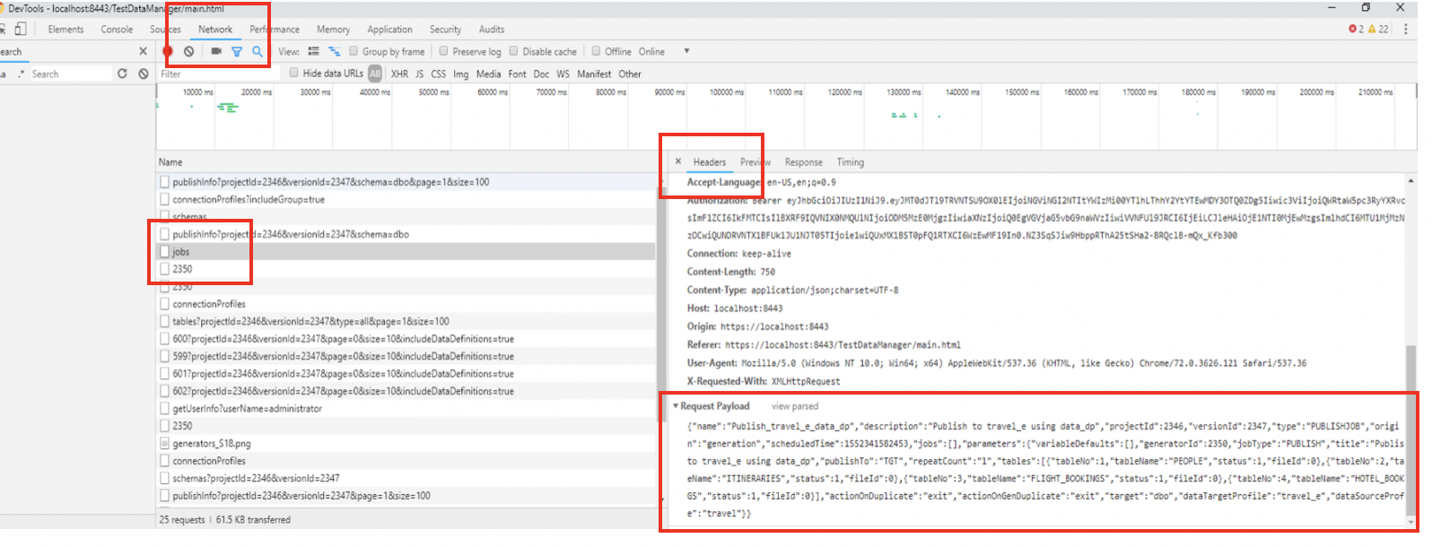

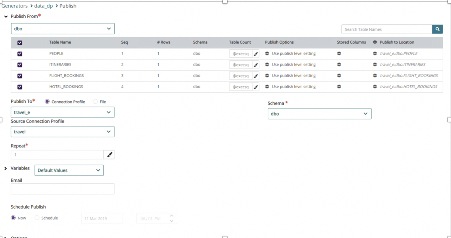

Invoke TDM Publish
TDM publish can be invoked by injecting publishService in JavaScript. This service has a method named – publishData which can be used to invoke a publish. This method will accept a JSON object variable with publish payload information. If the payload information is correct, it will invoke the publish.
To obtain the right payload information submit a sample publish from TDM portal and using browser developer tools and construct the payload JSON.
This example invokes a publish based on the following publish information and payload.
Publish from TDM Portal
After Submitting take a look at Developer Tools as shown below.
Note: this is a google chrome browser. But this information can be obtained from any other browser as well.
Construct the payload in JavaScript.
The parameters can be coded to load from variables.
Eg: publishJobPayload.parameters.variableDefaults = [{name: "Pep_Id",  value: $scope.peopleList }];
This takes value from web form “peopleList” is the people id chosen from the Custom SS Tile.
