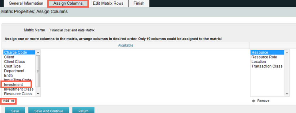

2. We have a resource whose rate varies by investment. Is there a way to handle this in the Rate Matrix? We don’t have Investment as an option in the Default matrix. What config(s) should we change/update to get Investment included in the rate matrix?
Answer
Add investment in the rate matrix. Simply open the Rate Matrix and from the Assign Columns tab, select Investment > Add > Save.

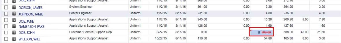

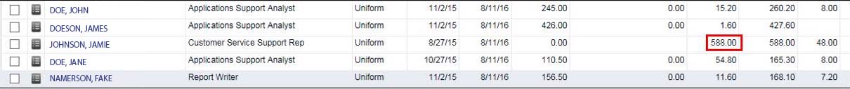

3. A project is complete, so I want to remove ETC from an Assignment on an auto-created “Effort Task.”  When I change the ETC to zero or just “delete” it, the ETC hours come right back.  From what I’ve read through google searches, the ETC can’t be removed, but I refuse to believe this.  Anyone know of a work around?  We aren't using OWB/MSP, so those aren’t options.
On an Effort task, we zero out the ETC:
After clicking save, the ETC comes back:
Answer
It appears the only way to wipe out the allocation of the resource is from the Team tab. As soon as you do this, the ETC goes to 0.
