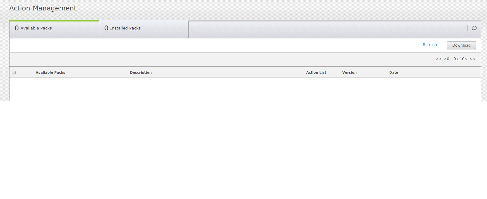

Q12: In new ROC I saw something Action Management? Can we use it to upload actions pack? What is the difference in two tabs it show available action packs and installed action packs?
Ans: Yes, we can use it to upload a package. The 'available actions' tab is the one you have on your system. The 'available actions' is the packs in the main repository that you can install into your system.
Q13: We see a scenario where in RA 5.0 and greater sometimes the Action Management tab's doesn't show any data? Can you explain why it is so?
Ans: The above scenario can be result of either the browser compatibility or daemon "Nolio Update service" may not be running on NAC Server. This service is required to responsible for calculating data for the above two tabs.
