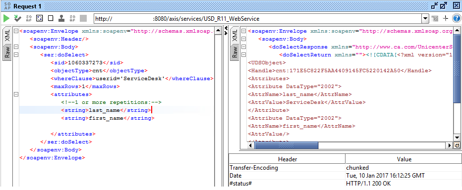

How to use DoSelect method?
Parameter
Type
Description
SID
Integer
Identifies the session retrieved from logging in.
objectType
String
Identifies the object type (factory) to query.
whereClause
String
(Optional) Identifies the where clause for the query.
maxRows
Integer
Indicates the maximum number of rows to return. Specify -1 to return all rows.
Note: Regardless of the integer specified, CA SDM will return a maximum of 250 rows per call.
attributes
String[]
Identifies the attribute list for which to fetch values. Dotted-attributes are permitted. If this field is blank, all value-based attributes are returned. These attributes cannot be defined as LOCAL in the majic definition file. LOCAL attributes are temporal; they have no database storage
Technical Reference Guide
http://<server name>:8080/axis/services/USD_R11_WebService?wsdl
<element name="doSelect">
<complexType>
<sequence>
<element name="sid" type="xsd:int"/>
<element name="objectType" type="xsd:string"/>
<element name="whereClause" type="xsd:string"/>
<element name="maxRows" type="xsd:int"/>
<element name="attributes" type="impl:ArrayOfString"/>
</sequence>
</complexType>
</element>
<element name="doSelectResponse">
<complexType>
<sequence>
<element name="doSelectReturn" type="xsd:string"/>
</sequence>
</complexType>
</element>
Request Example 01:
<soapenv:Envelope xmlns:soapenv="http://schemas.xmlsoap.org/soap/envelope/" xmlns:ser="http://www.ca.com/UnicenterServicePlus/ServiceDesk">
<soapenv:Header/>
<soapenv:Body>
<ser:doSelect>
<sid>1060337273</sid>
<objectType>cnt</objectType>
<whereClause>userid='ServiceDesk'</whereClause>
<maxRows>1</maxRows>
<attributes>
<!--1 or more repetitions:-->
<string>last_name</string>
<string>first_name</string>
</attributes>
</ser:doSelect>
</soapenv:Body>
</soapenv:Envelope>

<AttrName>persistent_id</AttrName>
<AttrValue>cnt:171E5C822F5AA4409145FC5220142A50</AttrValue>
</Attribute>
<Attribute DataType="2005">
<AttrName>organization</AttrName>
<AttrValue>B4815FDBC33BAD42B05C7A96AA2FEF83</AttrValue>
</Attribute>
</Attributes>
</UDSObject>
</UDSObjectList>]]></doSelectReturn>
</doSelectResponse>
</soapenv:Body>
</soapenv:Envelope>

02-08-2017 07:51 AM
Hi Matheus,
Thank you, we need to share knowledge.
How Do I know all object types?
Are you talking about SDM? I have already published some objects, any way, it's need to look the object using  bop_sinfo
or using WIKI CA SDM Objects - CA Service Management - 14.1 - CA Technologies Documentation
or a document from 12.6: Technical Reference Guide
I will develop an example for this, but from memory I believe it to be as follows:
<soapenv:Header/>
<soapenv:Body>
<ser:doSelect>
<objectType>cr</objectType>
<whereClause>ref_num='123456'</whereClause>
<attributes>
<string>id</string>
<string>status</string>
</attributes>
</ser:doSelect>
</soapenv:Body>
</soapenv:Envelope>
