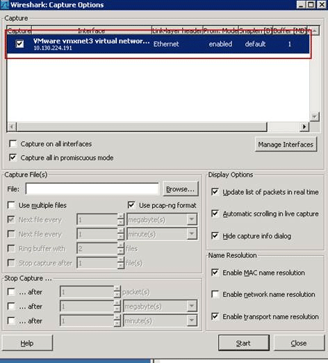

1) Open WireShark on the Harvester server and go to the “Capture” top menu and then “Options”
2) Double click the Interface which is receiving the NetFlow
3) In the “Capture Filter” field enter “host x.x.x.x and udp port 9995” where x.x.x.x is the IP address of the device you wish to monitor, and click OK
4)Click “Capture->Start” to begin capturing data.

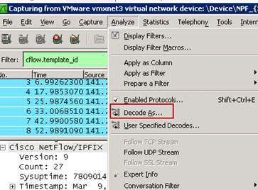

5) Once you have captured enough data click Stop and then “Analyze->Decode As”

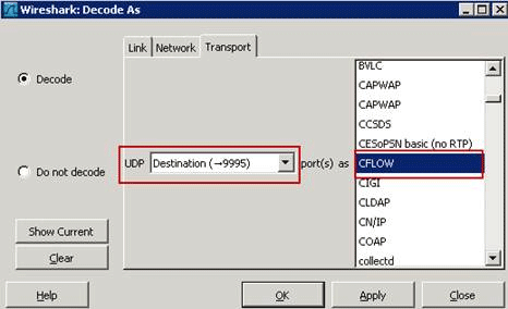

6) Change the drop down menu to “Destination (->9995)” and select “CFLOW” on the right and click OK

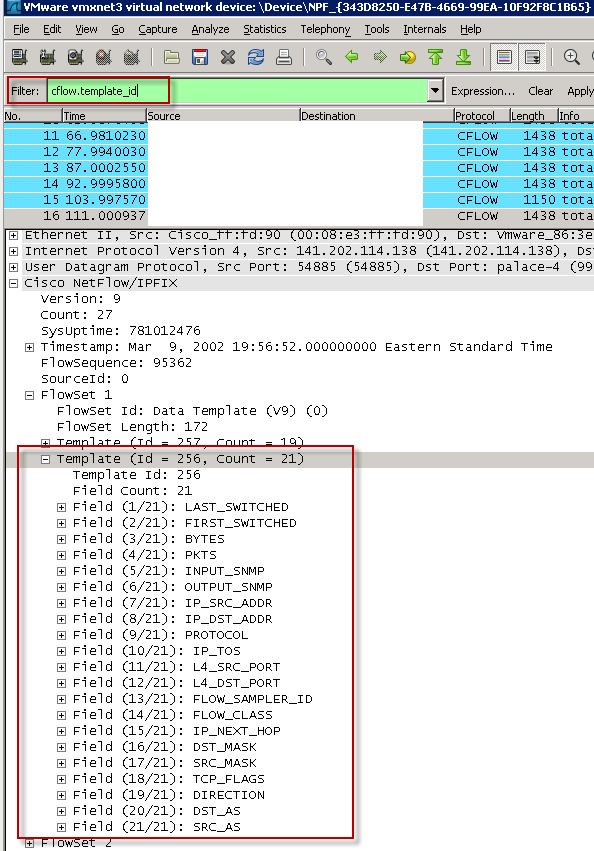

7) To find the datagram that has the Netflow template you can enter “cflow.template_id” in the Filter field and it will filter down to only datagrams that contain a Netflow Template.
Here you can check to see if the required NetFlow fields are being sent in the template.
If you expand the section below which says “Template (ID = ….)” You can see a list of the fields being sent and match them up with the required fields from above.

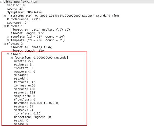

8) To view the actual values for these fields being sent, clear the cflow.template_id filter and click on any other datagram.
Expand where it says “Cisco NetFlow/IPFIX” and expand one of the Flowsets until you can see a list of the fields and values like below, make note that the "FlowSet Id: (Data)" value matches the template ID, like in this case it is 256, to ensure you are looking at the correct flow:
