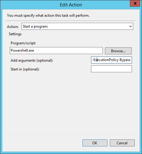

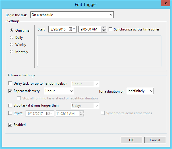

Creating a scheduled task to execute the script:
The following shows how to create a repeating task that is executed every hour.  You can adjust this to your needs.
  • Task Trigger
  • Task Action and Argument
  • Argument: -ExecutionPolicy Bypass D:\scripts\Webstat_Email_Task.ps1
