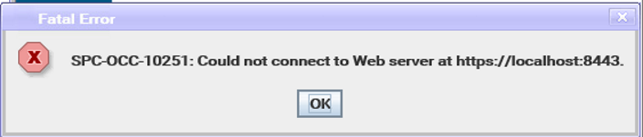

Error:
Solution:
This is due to a custom keystore name / location and / or custom keystore password.
Log in to https://<server_name>:9443/spectrum with spectrum / spectrum
Click on "Manage"
Click "Show Config"
In the field "JVM Arguments", check and change the trustStore and trustStorePassword parameters
Click "Apply"
