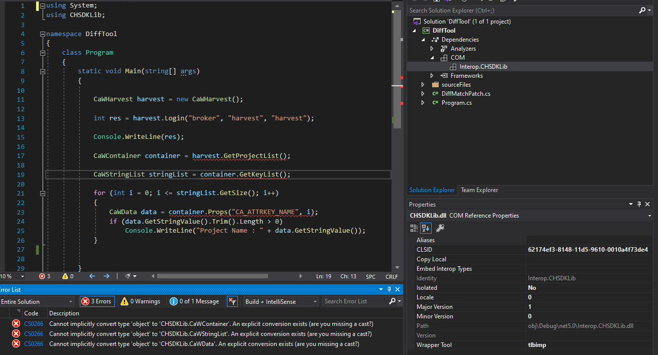

  • 23.  RE: Installing Chsdk on Windows 10 and Usage in C# project
    Posted Oct 22, 2020 03:41 AM
    Hi,
    on Visual Studio 2019 v 16.8.0 preview 5 (.NET Core 5.0, .NET Core 3.1) this won't even compile :(
    On Visual Studio 2013 12.0.40629.00 update 5 (.NET Framework 4.8) I get the same error, as I wrote before, when hitting line:
    CaWHarvest harvest = new CaWHarvest();

    Can you try using windows form application type project? With windows form type, i am able to use the chsdk without any exceptions.
    I also got the same problem with console type application. I will check on this.
    Let me know what you find.
    Thanks,
    Sridhar
  • 27.  RE: Installing Chsdk on Windows 10 and Usage in C# project
    Posted Oct 22, 2020 07:23 AM
    Hi,
    Yes, with project types WindowsForm and WPF (.NET Framework) it works :)
    But with WPF and console app (.NET Core) don't :/
    It will be nice if this library works with .NET Core since .NET Framework will not be supported in future.

    There is an error in your sample program. It should be like this:
    int res = harvest.Login("broker", "harvest", "harvest");
    Console.WriteLine(res);
    CaWContainer container = harvest.GetProjectList();
    // CaWStringList stringList = container.GetKeyList();
    int projectCnt = container.GetKeyElementCount("CA_ATTRKEY_NAME") - 1;
    // for (int i = 0; i <= stringList.GetSize(); i++)
    for (int i = 0; i <= projectCnt; i++)
    CaWData data = container.Props("CA_ATTRKEY_NAME", i);
    if (data.GetStringValue().Trim().Length > 0)
    Console.WriteLine("Project Name : " + data.GetStringValue());

    Hello Tomasz,
    You are correct, i did not observe that.
    As of now, are you OK using windows form application type for using chsdk?
    Thanks,
    Sridhar
  • 30.  RE: Installing Chsdk on Windows 10 and Usage in C# project
    Posted Oct 23, 2020 03:43 AM
    Hi,
    I prefer WPF application and .NET Core. Like I write before It will be nice if this library works with .NET Core since .NET Framework will not be supported in future.
    I start to write new application and I don't want to use old technology.
    Can we menage to chsdk works in .NET Core projects ?
