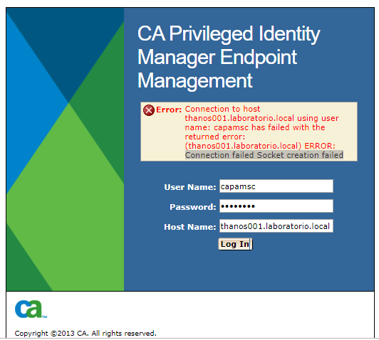

    Thanks for your answer, the installation of the agent worked correctly. I have the following error when trying to access the EndPoint administration console.
    Connection failed Socket creation failed
    The installation is in the test enviroment and hostname is fictional. This error is present only in the EndPoint´s that are installing with fix PAMSC_DE344290-14.01.0.315-_LINUX_64. The endPoint´s that are install with the DVD8114758E_CA_PIM_14.0_Endpoint_Components_for_Unix run perfectly.
    Some idea for this ?

    Hello Juliano,
    „Socket creation failed" is indicating a TCP connectivity issue from the Endpoint Management to the seosd on the actual endpoint.
    Please make sure you have not blocked TCP 8891 in both directions between both boxes.
    See https://docops.ca.com/ca-privileged-access-manager-server-control/14-1/en/reference/used-ports/unix-endpoint-used-ports for further details on the used ports.
    Should the issue remain, please open a formal Support Ticket and we shall analyse it accordingly.
