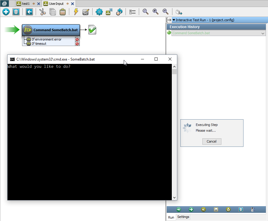

    And finally, the only way I can think of to interact with a test case during its run is to have an external process step, and have the external process ask you for the needed input. E.g. a DOS batch file that ask user input in a CMD window, see printscreen below of SomeBatch.bat during in ITR run. Problem is to get the user input back into testcase for further processing. The only supported way is user exits, so if a number is ok to take a decision in your testcase then that might work. If you need more then just a number than your batch file might need to write things to a file, and then you need also a step to read and process that file.
