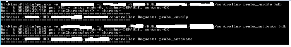

    More if the complete command is executed:
    E:\Nimsoft\bin>pu.exe -u admuser -p xxxxx /SER/HUB_SECUNDARIO/SPOBRPRD01/controller probe_verify hdb
    E:\Nimsoft\bin>pu.exe -u admuser -p xxxxx /SER/HUB_SECUNDARIO/SPOBRPRD01/controller probe_activate hdb
    The probes normalize.
    Can you help me in this , please.

  • 21.  Re: Robots installed from an image.
    Posted 12-06-2018 02:54 PM
    the script has the space conform was reported, the correct way.
    I ran the command step by step to validate the probes on the agents and it worked, as the log:
    Address:/SER/HUB_SECUNDARIO/vdihs5/controller Request: probe_activate
    Dec 6 17: 20: 45: 648 pu: SSL - init: mode = 0, cipher = DEFAULT, context = OK
    Dec 6 17: 20: 45: 648 pu: nimCharsetSet () - charset =
    Address:/SER/HUB_SECUNDARIO/vdihs5/controller Request: probe_verify
    But I put the full path in the direct script. My doubt would be in the variable:
    SET SHOSTNAME=/SER/HUB_SECUNDARY/%1/controller/probe_verify
    In the parameter "% 1" is the variable that represents the hostname by the nimsoft NAS. How can I verify this item?
