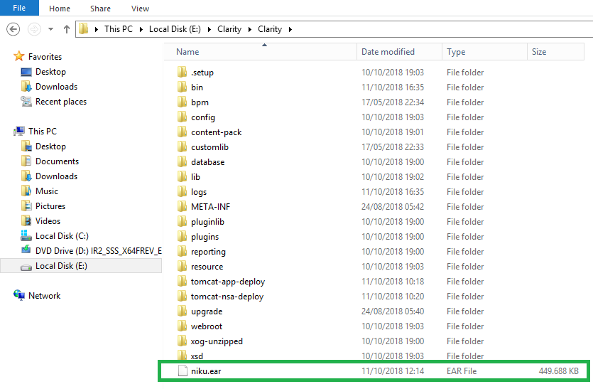

    When I select the Package application link appear a new button that says "Create Pachage".
    It download the niku.ear but I don't know how to install this and if this the solution.

    You can also disregard the niku.ear package and deployment; this is for non-Tomcat application servers like WebSphere.
