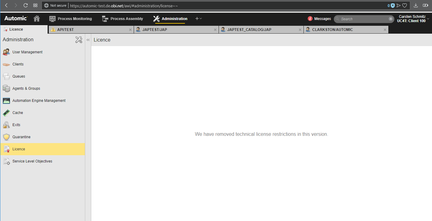

    We just updated 12.2.1+hf2 to 12.2.2+hf1 on "test", and the plan to update production soon stands, but my license overview now looks like this:
    Unless this means I do not need licenses anymore (doubtful), how are we to check our current usage and compliance? Just a hunch, is this possibly a remnant from a licensing-free development build?

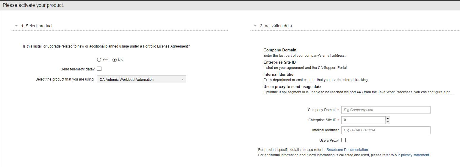

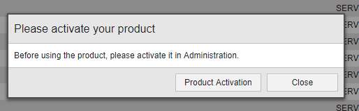

    Furthermore, this greeted us:
    Followed by this:
    Do we need to do this? What happens if we don't - does this disable or lock down any features? Were we informed about this and missed the memo; I can't at least find it in the change notes for engine or AWI. I don't know if I plan to use a Portfolio License Agreement because I don't know what that is. The documentation link leads to a huge scrolling list at CA, which redirects to the usual Automic documentation, where I could not on the fly find anything regarding this new process.
    Please kindly share your experience or clarify.
    Thanks!

    License Key Checks have been removed - please see the following post:

    To address the popup - the fact that this occurs even after activation is a known bug. You will need your Enterprise Site ID, but afterwards should be able to finish your activation. At the current time, this is not the case and the activation window will still pop up upon next login. We're investigating this issue internally, but don't have a resolution at this time.
    With this said, however, it is not required and won't stop any Automation Engine processing - only the ability to send telemetry data.

    But the vital question for me is this: as I can not imagine that Automic has now dropped any license requirements as a whole, how can we see our current license usage and ensure compliance, if the license overview is defunct?

    Licensing and contractual entitlement are two different things.
    The technical license checks in the product have been removed.
    The contractual entitlement remains the same so you can use whatever you are contracted to use.
    The license checks did not cover all technical entitlements before so the license overview did not always accurately represent entitlement.

    On the Activate Product popup, that has caused some confusion and will be renamed to something more meaningful in v12.3.
    It does not cause the product to stop working in any way.
