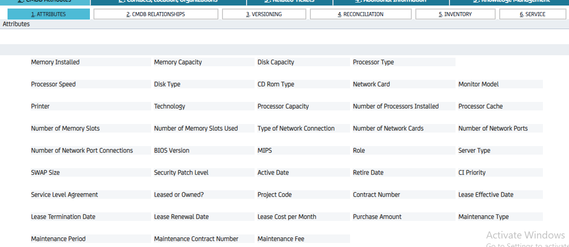

    We exported xml file from spectrum and import all the CI's into CMDB. But i can see alot of information is not showing in attributes tab against each CI...See the sanpshot below . Most of the information can be seen on SPectrum and i want complete information of CI's in CMDB what we have in Spectrum.

    My concern is how can i specify code in SPECTRUMAttribute tag??? Like for each CI , i need additional attribute like Memory Installed, memory Capacity, Disk Capacity ,Processor Speed etc. so what code i need to specify for <SPECTRUMAttribute> tag???
