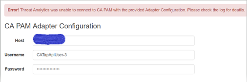

    I have a problem  with the integration between threat analytics y CA PAM Server.Actually I have a cluster in active-active mode and when I try to Configure the Threat Engine to use the CA PAM Adapter I get this:
    I checked the connection between CA PAM and TH, and everthing seen be right.
    I Checked if the TA user CATapApiUser is enabled in PAM,and it was.
    I have the External REST API option enable.
    What could be happened?

    Hi Daniela, how are you?
    Ensure that the CATAPuser-n matches with the -n in the target accounts.
    Go to Credentials >> Manage Targets >> Target Accounts.
    And search for the CATapApiUser-n
    In your case check that CATapApiUser-3 exists in Target Accounts
    Also go to Users > Manage Users > select CATapApiUser and go to the API Keys. is CATapApiUser-3  enable?
    Check also:
    https://comm.support.ca.com/kb/error-pam-cm-0264-unable-to-retrieve-risk-levels-from-server/KB000103121
    Also check the that TA and PAM have the same subnet Mask configured.

    Thank you Celeste, I verified that and the CATapApiUser-3  is enable maybe could be a problem with the NTP configuration ?

    Hi Daniela,
    Did you check the Network Settings?
    This is another reason why could be failing.
    I remember a similar case. Take a look at this Document:
    Unable to activate networking in CA PAM Threat Ana - CA Knowledge
