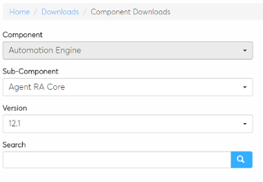

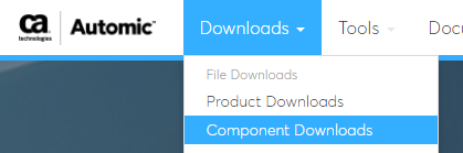

    In the Download Center use the Component Download Item in the Download Menue.
    Here you can select the Sub Component Web Service when Component Automation Engine is selected

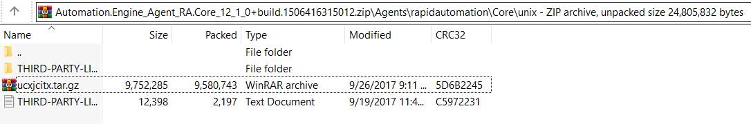

    The ucxjcitx.tar.gz file is part of the RA Core installation file.
    It can be download going to downloads.automic.com
    For the filter pick the following (change the version to fit the one you are on)
    Scroll down for the result and you will find a file/downloadble link with label "Agent RA Core"
    Inside of that is what you are looking for - ucxjcitx.tar.gz
