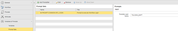

    Parent chain Prompt Set:
    Child Workflow Prompt Set:

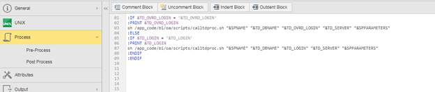

    I am using as follows in my Process tab but I am having same issue:
    Can you please guide me if I am wrong at Some point ?

    To be in detail I am calling a variable from a Prompt Set and writing my code as below in my Child Workflow(It Also has a Prompt Set) in Process tab but while my Job gets failed in chain then i needs to restart it then in the Child Workflow I will change my variable/Parameter value.When i restart my Workflow it needs to pick the Prompt Set value which was on top of my child Workflow.
    :IF SYS_ACT_RESTART() = "N"
    :PRINT SYS_ACT_RESTART
    :PUT_PROMPT_BUFFER &TD_OVRD_LOGIN = '&TD_OVRD_LOGIN'
    sh /app_code/bi/oa/scripts/calltdproc.sh "&SPNAME" "&TD_DBNAME" "&TD_OVRD_LOGIN" "&TD_SERVER" "&SPPARAMETERS"
    :ELSE
    :PUT_PROMPT_BUFFER &TD_LOGIN = '&TD_LOGIN'
    sh /app_code/bi/oa/scripts/calltdproc.sh "&SPNAME" "&TD_DBNAME" "&TD_LOGIN" "&TD_SERVER" "&SPPARAMETERS"
    :ENDIF
