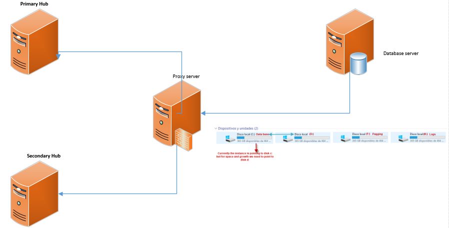

    Currently the instance is pointing to disk c: but for space and growth we need to point to disk d: Is this possible?
    1-. What steps should I execute to do it in case it is positive?
    2-. If possible, do I lose historical data?
    Thanks in advance for what you can help us

    And I think that your picture is likely wrong - usually the primary hub has most of the active connections to the database - that is unless the "proxy server" is a network device of yours and not a UIM device.
