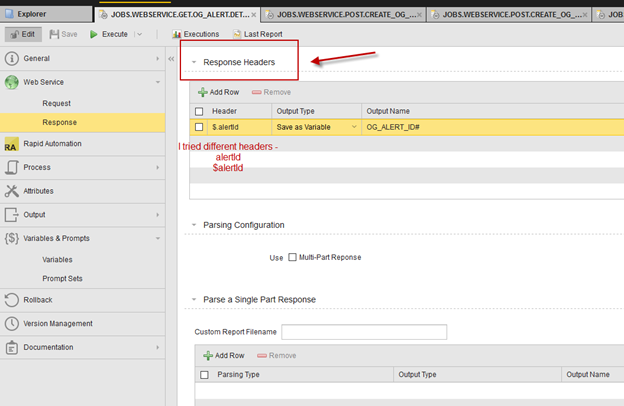

    Hi. I could use the communities help (again). One of our vendors is updating their API (from v1 to v2) and the new version's response page has changed. Long story short, I need to get the "alertId: " from the results of my request.
    I need to store the “alertId” into a variable so, I am using the Response page in the Web Service tab of the REST job/object.

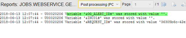

    I am able to parse for the “requestId” (highlighted in green) but NOT the "alertId" (highlighted in yellow). I tried several approaches but i'm unsuccessful. Any ideas?
    Output:
    • Try 1 - The job does not fail but the value is apparently not being pulled.
    Try 2 - The job does fail

    Resolution:
    We were able to get the alertId value by putting the following the following $.data.alertId as an expression. Be aware that the expression is case sensitive.
