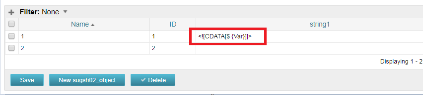

    Hi All,
    I need to insert the CDATA element as a string and it should not be recognized as CDATA by xml in gelscript, as this will cause the element not to be written as a string in the field.
    The result when writing to the object would be close to that of the attached image:
    <ColumnValue name="blabla"><![CDATA[$ {Var}]]></ColumnValue>
    CDATA recorded within a field
    Thanks in advance

    <ColumnValue name="string1">&lt;![CDATA[$ {Var}]]&gt;</ColumnValue>
    </CustomInformation>
    </instance>
    </customObjectInstances>
    </NikuDataBus>
    The result is below.  &lt;![CDATA[$ {Var}]]&gt;  is translated to  <![CDATA[$ {Var}]]>
    You mentioned "& gt;". Does it have blank? If so, please use "&gt;" instead of "& gt;".
