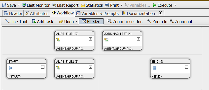

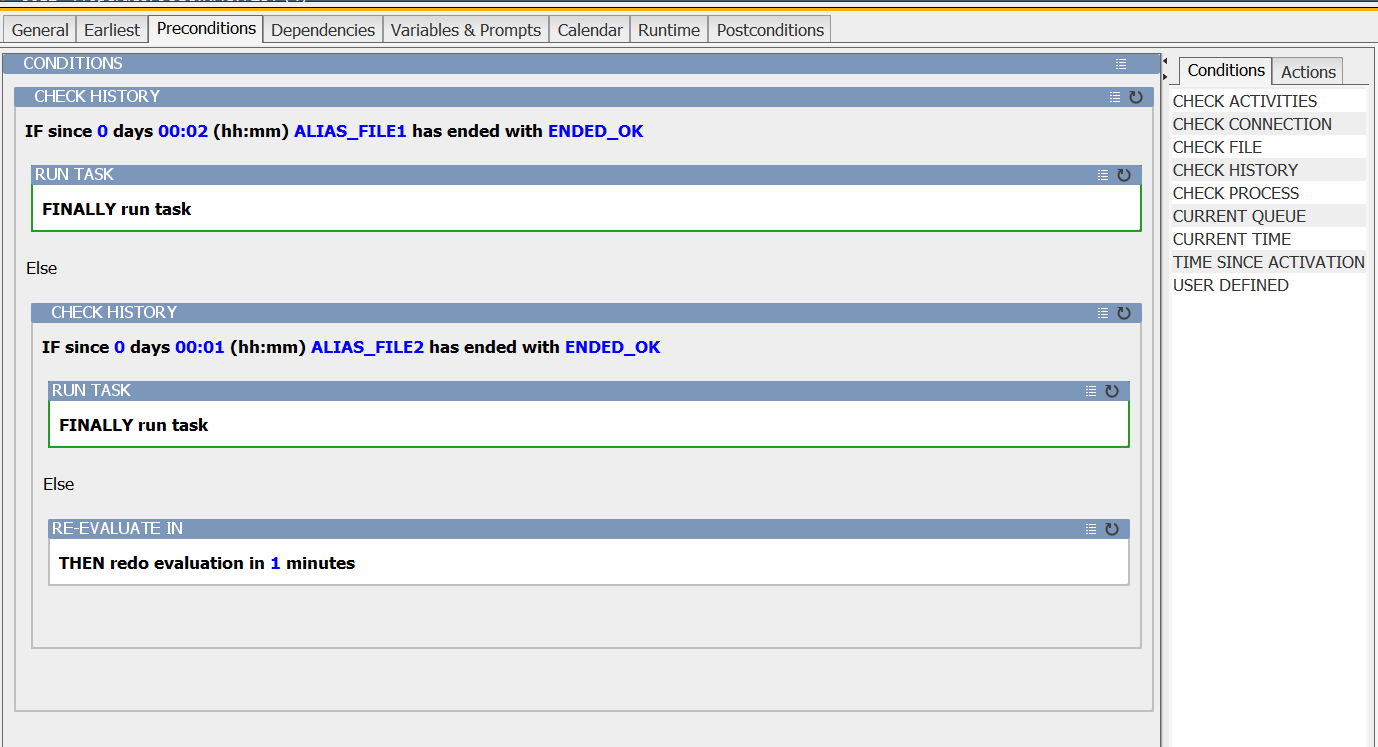

    Hi Wolfgang, Got small issue here ....   Here are my observations after testing...
    below is my JOBP
    first two jobs looks for file1.txt and file2.txt respectively and third job JOBS touches file called process.txt.
    As you see above, I have given the alias names  ALIAS_FILE1(original event name : EVNT.NAG.TEST) and ALIAS_FILE2(Original event name : EVNT.NAG.TEST2)
    And in the precondition of the JOBS.... below are the conditions .
    ***I am not using ANY_OK since the job is kicking off even the file watcher completed due to max time out of 1 min.

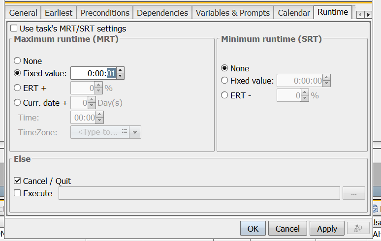

    OK .... As per your suggestion, in TASK PROPERTIES of the both File watchers  I have set max run time to 1 min ELSE cancel/quit as shown below.

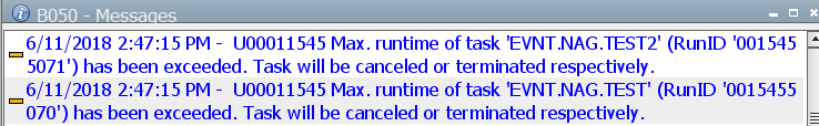

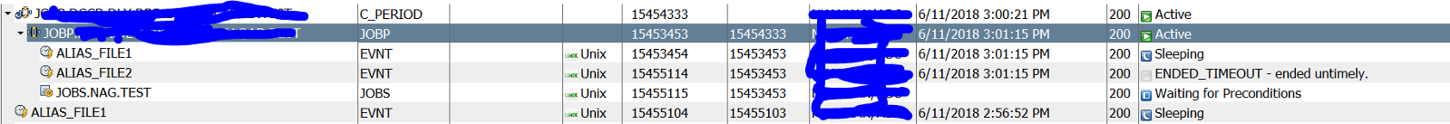

    Now the problem is as soon as I kick of my JOBP, following two messages are getting displayed in message window.
    So does it means, it is already cancelled ? or still running in back ground ?

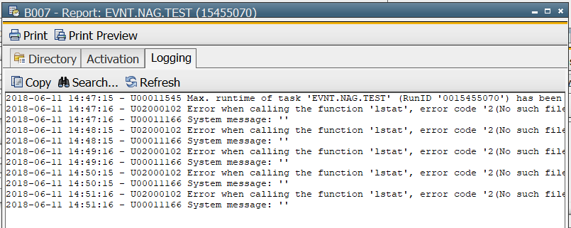

    what I found is these two tasks are still running in background even after 1 min and generating the following logs in report window.
    Now I created file1.txt and waited for the first file watcher to finish and then JOBS also got succeeded and JOBP also got completed and closed the monitor.
    But in activities window, I can still see the second file watcher running alone (outside of JOBP)
    I ran the JOBP again and I touched file2.txt this time and ALIAS_FILE1 was appearing in activities window this time.

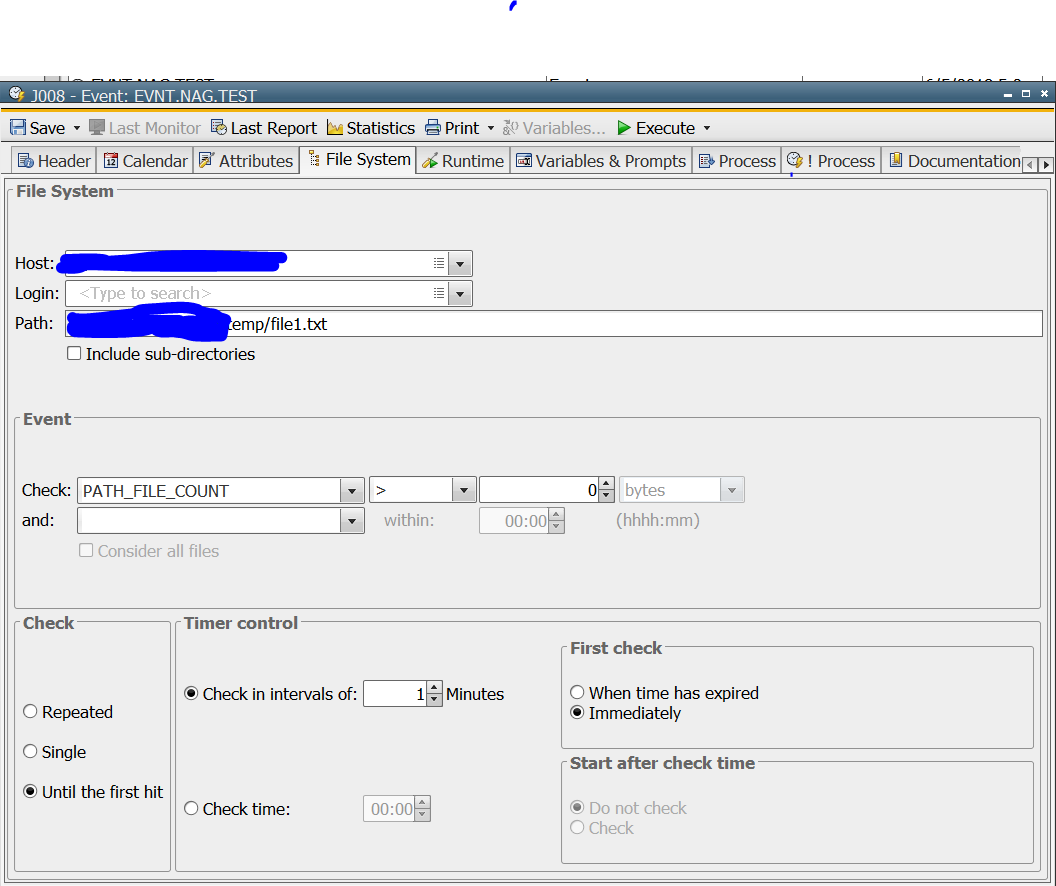

    Can I avoid of running these file watchers after JOBP is done ?  Also see the properties of events below

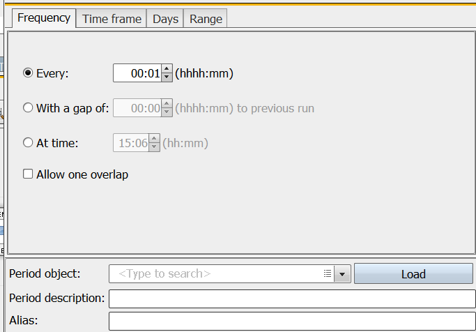

    Next I ran the JOBP in recurrence mode for every 1 min. see the properties below.  But it is never getting completed even there is file2.txt.
    see the activities window below...
  • 17.  Re: Execute a job if any one of the prior jobs completed
    Posted Jun 12, 2018 02:24 AM
    Hi
    you defined one second as MRT - thats a bit too short :-)
    Minimum one minute, better 2.
    cheers, Wolfgang
  • 18.  Re: Execute a job if any one of the prior jobs completed
    Posted Jun 12, 2018 07:42 PM
    Still that issue is there. I am not sure where I am doing the wrong. I tried multiple times, but only time time I have seen the Event file watchers ended with status ENDED_TIMEOUT. All other times including latest run, the F1 and F2 are running even after they timed out. see the settings below.
    Below is my JOBP. first two file watchers with the above mentioned properties (from previous post).
    I have started this job in recurring mode for every 2 mins. I can see that the file watchers are ending with ENDED_TIMEOUT. But the third job is keep on running. I created the file file1.txt, of course nothing happens because file watchers are already dead. But JOBS is still running.  Then for JOBS, I kept 3 mins as Max Run Time (MRT). But still that job is not ending. Any clue ?
  • 19.  Re: Execute a job if any one of the prior jobs completed
    Posted Jun 13, 2018 03:38 AM
    Hi
    => I would set the MRT for the whole workflow, so if the file watchers do not find the files it should be cancelled including all objects in it.
    Why Your EVNTs run outside the workflow I have no Idea, con only guess it was started seperately by mistake...
    cheers, Wolfgang
  • 20.  Re: Execute a job if any one of the prior jobs completed
    Posted Jun 13, 2018 03:39 AM
    Hi again
    the -outsde running EVNTs do have a parents - see screenshot - I sppose thsi is a workflow....
    cheers, Wolfgang
